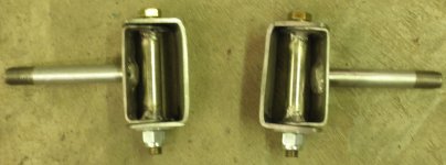

My latest fabrication project is a downhill racer for my almost 7 year old grandson. The rules are fairly loose - maximum weight, maximum height, maximum length and maximum width, and working brakes and steering.
I plan on laying up a fiberglass body once the chassis, steering and brakes are complete.

This is a picture of one of the mostly completed steering spindles.
This is what I started with to create the steering arm.
The next three pictures show the finished steering arm and the mounting of the steering shaft.

Fantastic work Jeff, keep the photos coming , dont forget the 'akerman' steering angles . the steering arms off the stub axles should be pointing at the center line of the rear axle in the straight ahead position to get the best response when the wheels are on a sharp lock, (inside wheel then turns tighter radius on turns) otherwise you get tire scrub (dont ask me how I know that). And it looks good too. knowing hotrodders will notice your handywork.
To rework them you could just cut a notch to the bottom flat of the angle section of the arms bend inboard and reweld

Does this go mostly in a straight line??? You have what looks like no kingpin inclination(caster) and no camber which helps it corner. If this is a downhiller you want it as free as possible, you will need to play with the toe as well. Remember this just my opinion but it looks like the way you have it set up now it will be a handful to drive. Don't know what speeds you will encounter, but that depends on the hill. Handling is everything when your engine is gravity. Where you put the weight, which in this case is the driver, is very impotant. Lots of good info out there on steering geometry........

ooooh, I think I would have put a lot of caster in it. On the drag cars my buddy builds, they have a lot of caster so that they sort of correct themselves.

I thought about building in castor, but then remembered all the soap box derby cars that have been built over the years and the crude downhill racers I built when I was a kid that had no castor because the wheels were attached to a 2x4 that pivoted in the middle. Since castor, as you inidcated, affects the self-centering of the wheel and this is basically a straight line race, I decided to forego that. The fast cars last year hit about 25 mph. Anyway, Sunday we will be doing some trial runs and I will see then if anything needs to be re-engineered.

I think you'll want some caster as well. It most likely will want to wander all over as is and require constant input.

Friday night, my son came over and helped me set the toe-in to 0. While he was there, he climbed in the car and I gave him a quick shove across the shop, which led to a panic stop and a failure of my brake pedal. I had wondered, when building it, if it would be strong enough. I spent yesterday reinforcing it with some strategically applied angle iron.
