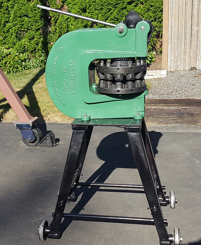

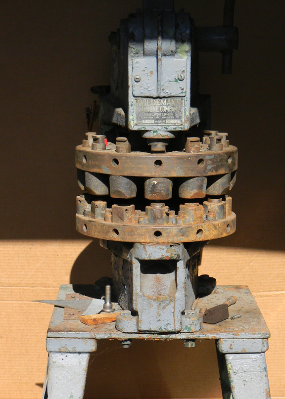

I like to restore old machines. I saw a turret punch recently that looked like a good candidate. Here are before and after pix:
Before:
After:
Thanks for looking!

For those who don't know that is a hole punch. The upper round carrier carries a series of punches in different sizes and shapes. The lower carrier has the die. If you want a 1/2" hole in a piece of material you rotate the carriers till the 1/2" punch and die come to the front and then align the material and pull the handle. Very easy to do a lot of holes quick if you set up a guide.

This turret punch is set up to make holes, not slugs. The way I work is to lay out the hole centers and then center punch them. I installed punches that have center points. I use the center points to find the center punches and then punch the holes right where I wanted them. This does produce slugs but they are deformed somewhat by the center points. You can flatten them with a hammer but they don't look pretty.
I like punching holes because it's so much faster than drilling them. I already had several kinds of punches but all of them only mount one punch/die set at a time, making switching between sizes cumbersome. The big advantage of a turret punch is that you can simply rotate the platens and punch a different size.

I'm surprised they don't have the upper and lower turrets linked to turn together, avoiding the possibility of mismatching the punch with the anvil.
metalmagpie
Nov 1, 2011
799
Seattle
That's a Rotex thing. My turrets are linked. All Wiedemamn turrets are.
