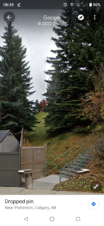

AndyL
Feb 22, 2012
1,371
Vancouver
Old belt drive ransom 42"
Used to cut a condo in my youth you couldn't stand on the slope, but at a fast walk you could sidehill nicely with the ransom. Just be ready to grab clutch and turn 180° downhill if something got awry.
The hydrostat upgrade resulted in tumbles and fences getting replaced.
Quick Google maps search... Figured I'd throw in a picture to add some idea of the angle for comparison.
