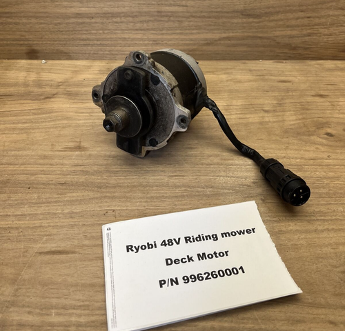

What are you trying to prove? We are talking about riding mowers, and you show a push mower motor? Did you even look at the pictures?
Do you think a servicing dealer, one that has pick up and delivery service as we were talking about is going to jerry rig a push mower motor onto riding mower, let alone a used one?
Would you buy used spindle bearings to put in a gas powered riding mower? How do you know the bearings are good?
48v ryobi riding mower deck motor ebay
Guess what, even if you get the right one above, a dealer isn't going to install your used parts and then give you any guarantee on their work.
1) The riding mowers use the same blade motor.
2) Why would I pay someone else to turn a few bolts?
3) It's a bog-standard BLDC motor. There's no reason to pay $300 for one.
Firebrick43
May 12, 2015
14,466
West central Indiana
NO they don't, I even linked the correct one, they are not the same. THe riders are longer in the case
Context, read the post I was responding to, I wouldn't pay anyone to work on my equipment but the post I was responding to(post 53) was using dealer pickup/delivery service. Its disingenuous to have a conversation and switch the context but you sure are trying.
Again context. Dealers are not going to order and install anything other than factory parts.
and what ever "bog standard" is well Its not. If I type 48v BLDC motor in there are none that come up with the same mounting scheme in pages with of google or duckduckgo except for alibaba and buy wholesale china that the minimum buy is 50 pieces nor in ebay. People generally are NOT going to make adapters and spacers to put new motors on when needed, they are going to go buy factory parts.
