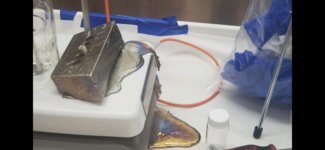

no704
Apr 27, 2016
5,232
Bismuth has a pretty low melting point and is a good substitute for lead.
