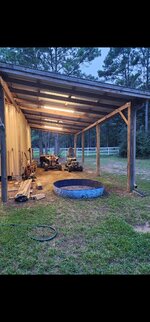

Codyboy
Jan 31, 2019
1,781
S.E. TEXAS
Aha ! call it a porch ! good idea
may just call city inspections and discuss with them, see what they let me do
thanks
Let?
So glad I don't have to deal with that.
My lean too's one each side are 14x32. Attached to the building. Has 6x6 post in the front corner concreted, 4x6 for the other 3 posts with the corner post concreted.
Double 2x6 header/rim joist bolted to the posts that are notched.
2x6 rafters about 3ft OC, 2x4 purlins about the same. Metal T panel for the roof.
