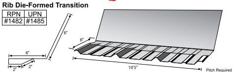

Indeed my siding is horizontal. I know I need a plan for that joint, but I'm not sure what that needs to be. What shape(s) sizes is the flashing sold in? I assume a simple "L" shape would do the trick?
I have seen some cut out a section of the wall tin about the size pf the ledger board and then bolt the ledger to the posts/studs. The best flashing would match the ridges in you roof panel.
If you use flat flashing, dirt/rain can blow back up under it and then down the wall.
