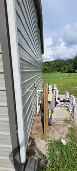

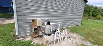

I have a 30x60 shop that I have managed to completely fill up and I would like to add onto the 30ft wall side with a basic walled in lean-too. I have tried to search for the trim pieces that would be need but either overlooked or misunderstood exactly what I would need. I looked at the mueller trim catalog and saw some pieces that would work for a metal building that had the ribs going vertical but didnt see anything that worked with horizontal ribs. Which poses an issue with the lean too roof to wall transition as well the transition from the lean to wall to the shop exterior wall. I have included some pictures to see if that would help. Any guidance is greatly appreciated.

I have a 40x60 Mueller building that I added a lean-to on. But I can't solve your problem as our R-panel is vertical.
The extension here is tucked "under" the original gutter/eve, but follows the slope of my roof... You're trying to do it off the end of a building.
Have you called over at Mueller? I've found that their sales reps actually know a think or two about fitting these puzzles together.
