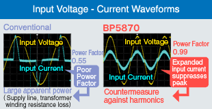

Its not just the inrush current, its also the "Power Factor". The circuitry will draw high amounts of current during short durations during the waveform.
A 300W device that has a power factor of .5 draws as much current as a 600W device, even though its only drawing 300W.
