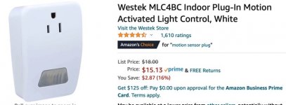

Would there be any way to make them easily motion activated? Maybe something that you plug it into that then plugs into the wall?

A PIR Motion Sensor will do the job.
WARNING: I'm afflicted with "Lame-Old-Dude-itis"
Looked them up on Amazon and I haven't a clue how they work:dunno:
I have to assume they would plug into the LED strip in some way?
I just installed one of the below gizmos on the 4ft LED above my sink and it works great. I'd use one of these unless I could figure out these PIR things
