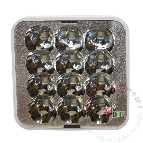

I need some feedback on a potential for shop lights. I will have a 12v off grid solar panel system for the lights and motorcycle(s) charging system. I found a great deal on craigslist for LED emergency lights that I think I can use as overhead lights for my 12v sysem. Check this out. It says for 120 or 277v, but the battery backup is only 3.7v. I know LEDs will work at different voltages so I wonder if these will work as overhead shop lights at 12v, or perhaps 24v. Any input is appreciated.
Just after posting this I found the tech sheet on the lights online. And it dawned on me these likely have a transformer or an inverter in them to take 120v AC down to a DC voltage for the lights themselves. That would explain how the lights can work on 3.6v DC backup batteries. It also indicates the lights themselves are meant to work at less than 12v DC. So now I wonder if I can use the lights themselves without the transformer/inverter and simply wire them to direct 12v DC. My solar system will have a 12v battery storage system as well for darker days when the solar isn't putting out quite enough.
The other side of this is how many Lumens per square foot for a shop. From what I've found its about 50 to 100 lumens per square foot for a shop. Anyone else have any input?

Those are about as bright as a flashlight. Not nearly enough light for a shop.

I agree with Bert that the lights you show are designed to show you the way to exit a room in the event of a power failure. They don't have batteries large enough for extended use.

I may have misunderstood you, but I think you have it wrong. The lights CHARGE batteries off 120/277 VAC. When the power goes out, the batteries kick in and the lights come on. For about an hour. The LEDs they use in those fixtures don't have the longest lifespan. They wouldn't do well as any sort of lighting system long term.

Emergency light fixtures are designed to provide adequate egress lighting only = average 1fc at floor. Good workshop lighting = 93 fc @ 30" workplane.
FWIW, if the battery output is 3.6V, then that is likely the voltage the LED arrays are design to operate at. Connecting the LED arrays to 12V would burn them out instantly.
Your pictures look very similar to this fixture (link). Here's the uncovered head of that fixture:
We see 12 LEDs. The site states 1.8W per head. The battery = 3.6V.
1.8W/3.6V=0.5A = 500mA (Ignoring any intermediate power consuming circuitry for current control which is required)
You don't really need this next piece, but heck we're here and I can't resist:
Since most LEDs are ~3V it's likely that these 12 LEDs are wired in parallel, thus 500mA/12 = 42mA per LED. If 1 LED fails, the rest will remain lit, now with higher current 500mA/11 = 45mA per LED.
Lets assume you only have the LED Head and there is no current limiting resistor on-board (current limiting resistors are the cheapest least efficient method of controlling current). I'll also assume there's no other current limiting circuitry on-board. You must have something to control the current. As LEDs warm up they will continuously draw higher current until they die. Current control can be achieved with inexpensive buck drivers (link)
