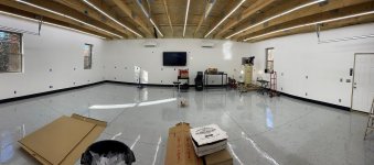

justjohn
Dec 30, 2019
25
South Carolina
These are from Amazon and are UL listed. Haven't noticed any door opener issues or wifi problems. Radio is internet based so hasn't come up.

BentAero
Nov 21, 2019
8
Upstate SC
I've got a couple cheap LED shop lights from Lowes. I have no problems with the door opener, but they cause strong 'static' with FM radio reception on the garage surround-sound receiver. No problem when using it in wi-fi mode.
HogDude
Dec 25, 2020
229
Nebraska
That garage is stellar. Please post more pics when finished.
Do you remember which lights you bought off of Amazon?
