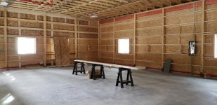

I am not an electrician and will confess to only skimming this thread, but are you considering dimmable LEDs?
My main work area is 48' wide and 36' deep with 14' walls.
I am using 7x fixtures (*) 150W LED Linear High Bay, 18,500 lumens, 5000K. These will be hardwired to a dimming switch. The circuit required metal-clad wire with 5 strands.
I only have 4 of them installed right now, and the walls haven't been painted (white) (much less sheathed) nor the epoxy applied on the floor so I ought to have plenty of light.
Also put LED can lighting in the soffits . . . happy snaps attached
(*) https://www.homelectrical.com/150w-2ft-led-linear-high-bay-120v-277v-5000k.tcp-hb15000150.1.html

Menifee Valley Speed Shop - 4ft 2-lamp strip lights yielding around 5000 lumens are a good option for workshops with ceiling heights below 11ft. In the 11 to 13ft area consider 3-lamp strip lights or integrated LED fixtures around 8000 lumens. You can use higher lumen fixtures if you find a good deal, but you'll want to put them on dimmers and follow spacing criteria rules to maintain even illumination. Though not all fixtures have the same spacing criteria, it's generally safe to assume a spacing criteria of 1.25 for a medium distribution fixture.
Calculation works like this:
(Ceiling height - workplane height) x spacing criteria = max center to center fixture spacing
Example with a 10ft ceiling:
10' - 2.5' = 7.5' x 1.25 = 9.375' (Max center to center fixture spacing for even light distribution in a garage with 10' ceilings.)
Edit: Note calculation assumes fixtures are surface mounted to 10ft ceiling. If fixtures are hung below 10' ceiling - like at 9', then you'll have to redo the calculation. As fixtures are lowered, max center to center fixture mounting distance is reduced (to maintain even distribution).
