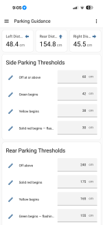

This is easily one of my favourite garage hacks ever. I have three LED segments around the door, LEFT, REAR (top of door) and RIGHT which turn green, yellow, red, or flashing red to guide (my daughter mostly) to park in the correct spot so car doors don't hit the lift posts, and the car is correctly distanced from the garage door. This YT short (about 2 minutes) pretty much illustrates how the system works. Links for all the bits you'd need to replicate this project are in the YT description.
The project uses Home Assistant and the ESPHome integration to program three ultrasonic (and quite accurate!) distance sensors. ESPHome makes this super easy and there are only three wires to connect up. This control panel in Home Assistant lets you enter the distances you want for the red, yellow, green parking/LED ranges. I will likely use this all the time (for live distances) to get cars correctly positioned for lifting on the hoist as I otherwise usually park, get out, reposition, then repeat one or two times.
These are the bits for each distance sensor:
This is the pinout for the $7 ESP32 board. You're only connecting three wires to it: ESP32 VIN to Sensor RED, ESP 32 GND to sensor BLACK and ESP32 TXD2 (Pin27) to sensor WHITE.
Here's one of three sensors. WIFI connected, powered by USB. Less than a watt each for power use.
View from the car if you get it right:
Code that you can use to program the $7 ESP32 board in ESPHome to work with the $30 ultrasonic distance sensor:

These are the generic entities you would need to replace in the code below:
binary_sensor.garage_door_contact
binary_sensor.garage_motion
sensor.garage_distance_left
sensor.garage_distance_rear
sensor.garage_distance_right
light.garage_wled_master
light.garage_wled_left_segment
light.garage_wled_rear_segment
light.garage_wled_right_segment
switch.garage_side_lights
light.garage_auxiliary_strip
This is the automation code (santized) used in Home Assistant to control the lights for parking:

The distances red circled below are displayed live. The data is updated a few times per second. So rather than program the red/yellow/green distances in that dashboard, I would just use a cheat sheet for each vehicle and pop my phone onto the dash while getting the car oriented for the lift. Our Highlander for example is relatively wide, so I park it closer to the passenger side post so I can get out!
Come to think of it, I'll just update the dasboard so I can directly enter target values for specific vehicles...good idea!! It seems that I often park, turn the car off then get back 1 or 2 times to get things right. This will just make that a bit quicker and more precise :)
