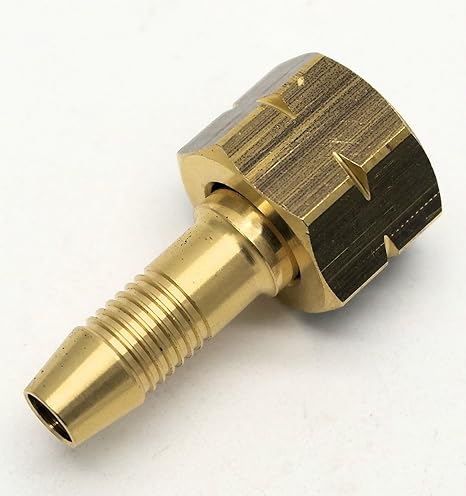

Here's a question, guys: Are left hand threads the same pitch and TPI as right hands threads, just backwards? Or, are they unique to lefties? :headscrat
Yes, everything is the same, except the direction of the helix.
As far as where to find LH threads, I can't think of anything new. Acetylene regulators have been mentioned, but I think its worth adding that any fitting when being used to carry flammable gas will typically be in LH thread. Hopefully, it'll be identified by cuts on all 6 corners of the hex portion:
