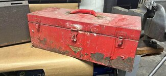

Thanks for the feedback. FWIW, Snap-on catalog "R" (1946) lists the K-24 with "Smooth grey enamel finish." and catalog "S" (1948) lists the KR-24 with "Red enamel finish.". So, it's either a transitional post-war K-24 or a KR-24.
Now I'm suffering that eternal debate - to strip it and repaint it or not. I cleaned it up gently this morning but it just continues flaking paint on the outside. I generally fall into the "it's only original once" camp, but this may need to be repainted. I might first try hitting it with a satin clear to see if it holds. I can always repaint it afterwards if it doesn't, I suppose.
The rust looks horrible, it's a nasty canker that's working away to completely destroy the actual box.
This one needs a repaint, and that will be part of it's history and preserve the actual core item. Paint is a sacrificial protective coating that needs renewing if necessary, you even can easily get a new sticker too and it could look great and last for many more years.
Is it only continuing to flake on the front where it's already flaking, Bill? Or is it equally brittle on other panels? There is A LOT of original paint left everywhere else on that box! There is a compromise between stripping or leaving it alone. Just scrape that front area and only as far/much as it flakes. De-rust. Then only touch up that area or spray just that whole panel. You may not find the exact shade of that aged red, but I am confident you can get close enough that it won't be noticeable, especially because it will always present differently in the light than the top and side panels. ALL boxes do that, even when new. That decal is available from the eBay repro guy.
misterbill
Dec 24, 2015
676
I decided to leave the question of repainting as a problem for future Bill. :D I scraped off the flaking parts and covered everything with a satin clear. We shall see how that holds up. I also ordered the decal in case future Bill decides to repaint. (I also think that there is a can of Rustoleum Sunrise Red laying around here somewhere!)
