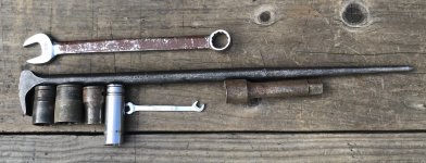

30,674
As you may know, I only buy things on eBay when I'm desperate to complete a set with something I just can't seem to find in the wild, or when it's something special. I was watching and bidding on this unique midget bits set recently, which somebody else won for $47.00. I wanted it, if only for the novelty, but I didn't want it that bad. I did steal the photos, though, because it's the weirdassest thing I've ever seen "associated" (which might be too strong a term..) with Snap-on.
If you're not quite sure what you're looking at, let me describe it, so you don't doubt your own eyeballs.
Yes, that is a vintage snap-shut eyeglass case.
Yes, it has the Pittsburgh area Snap-on dealer sticker on the lid. (The dealer had been at that address since 1958, if you're curious.)
And yes, that is a Snap-on 1/4" x 5/16" Ratcheting "Boxocket" wrench.
You may not recognize the little bits in the see-through vinyl case (and the eBay seller never provided photos of them out of the case...), but I do. They are Chapman 1/4-inch hex drive hex wrench and screwdriver bits.
Are you starting to put two and two together yet?
If not, perhaps this photo of my vintage wartime Chapman CM-1400 midget bits set, in its original factory case, with its original Chapman ratchet, and all the bits, will help!
Got it now?!
Somebody was copycatting Chapman. I don't know if it was actually the Pittsburgh Snap-on dealership itself - although the sticker sure seems to suggest it, but somebody put this set together to mimic a Chapman set, with the intention of turning the Chapman bits with the 1/4-inch drive hex opening in the Snap-on Ratcheting "Boxocket" wrench instead. If it was the store, it only makes you wonder if they were doing it in quantity. Buying bits from Chapman, buying the Ratcheting "Boxocket" wrenches from the factory, buying eyeglass cases from an eyeglass case maker and putting their sticker on the lid.
