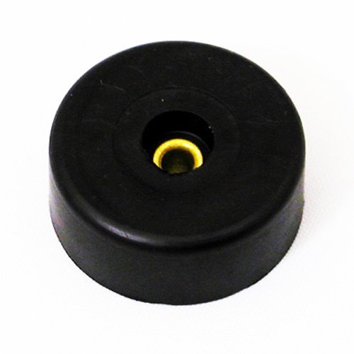

WD: the rubber feet can be bought at Lowe's and the part #'s are in this thread several times.
GRINDER FEET REPLACEMENT OPTIONS AND CONSIDERATIONS
(1)
Grainger link for style below: (not certain which size you need)
3MPK5_AL01
(2)
Or make them out of hockey pucks
(3)
Preblocks take different feet than your run of the mill block grinder. Photo below modified from jakemac's post to illustrate.
Link to comparison post
(4)
Lowes grommets:
The Hillman Group 5/16-in Rubber Grommet
Item #: 423532 | Model #: 884633
(5)
User Balane just got some rubber sheeting and cut a piece to go under the entire grinder.
Link to post
(6)
My measurements for pre-block feet are as follows:
Installed in grinder base : 1-3/8" diameter x 5/16" thick
Installed in tool rest: 1-3/16" diameter x 3/8" thick
Something like the part below would probably work for pre-block grinders with an appropriate fastener, but you'd possibly have to modify it for thickness (maybe sand it down - or not). I'm ordering some and I'll report back whether they work.
Amazon link

Pendragon: thanks for putting that list together for us Block heads. does yours have more information than TM's or maybe this one was his? nice work. :thumbup:
Some of the info I gleaned from a search of this thread. Some of it I added (mainly the pre-block replacements on amazon, which I am in the process of checking out). I don't think there's a section on feet in the resource thread, yet.
