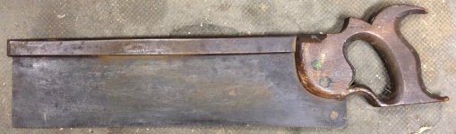

I just picked up a 12" Disston back saw from an estate sale for $4. Even rusty as it is, it cuts a beautiful kerf. What do you do to clean up a blade and sharpen a saw like this?

Anyone know how to clean rust from one of these?
I tried Comet cleanser and a green scrubber/sponge combo. Seemed to work fairly well for the most part.
Evaporust,electrolysis, or a vinegar soak. Looks like most of the blade etching is gone already.
Mark Harrell is a great saw sharpener/re-habber but he isn't cheap.
http://www.badaxetoolworks.com/index.html
BTW that is a nice looking Disston.
Thank you for the information.
I didn't see any evidence of blade etching before, during or after my initial cleaning. Some just didn't have it.
The teeth are funny to me. They have no set, but have like a 45 degree angle to the sharpened faces. Rip or crosscut? 14" and 14TPI BTW.

Bill- Head on over to vintagesaws.com. In the Library section there is info on cleaning and sharpening old saws in addition to identifying what type of Disston saw you have. In answer to your later query, this is a small backsaw and is filed to be crosscut.
Oh- and don't try to remove the saw nuts with a regular screwdriver or you'll ****** them up.
