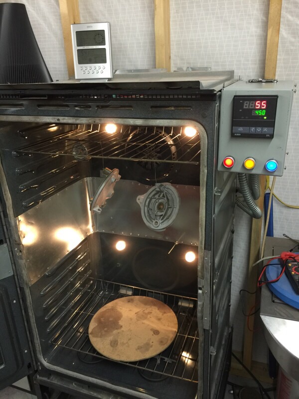

I'm in the process of gutting this ...
View media item 50166
... and putting it into this.
View media item 50167
The carcass is an unusually sized file/shelf cabinet. It's slightly larger than 4 drawer front loading file cabinet. The drawers opened from the side however and when gutted it's deep enough to take 16" wheels (I've since removed the vertical piece in the centre). I plan to encase it with metal studs, insulate it and then skin the outside with sheet metal. I'll have to build a door for it and that should be pretty straight forward (metal studs, insulation, sheet metal skin, hinges, handle, rope seal, etc.).
The control panel from the original oven is removable and it will be attached to the top of the new cabinet.
So far I have $125 into this project ... all spent at ReStore.
One more thing for the project pile. :lol:
