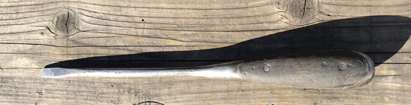

Found this one in a field in Texas nar 30 years ago. Probly belonged to some farmer. Big end has been hammered on quite a bit. Use it once in awhile.
30,990
Although anything is possible, I'm not aware of Irwin stamping the shank length inside a triangle on the face of the tip, Don. And the rivets are also the two-part kind. I suspect Tobrin or Ryan on that one. I moved mine on or I would post some side by sides.

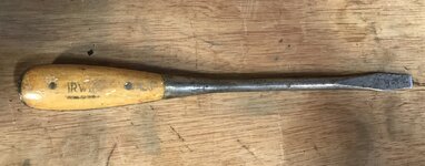

16,708
Some big and small drivers in various styles. Largest shown is just over 25" long, and the smallest is under 3" long. Unfortunately the large drivers have had their wooden handles beaten to destruction (but that's what old-tool scavengers frequently encounter). The larger screwdrivers include a "Stanley, Hurwood, No.20, Made in Can", and a Perfect Handle labelled "Irwin, USofA, Gov.Stock #41-S-1076".
The Irwin with the Federal Stock Number 41–S-1076 is Korean War era. The WW2 versions are ink stamped on the handle which quickly wore off.

16,708
The Irwin screwdrivers with the ink marked handles are difficult but not impossible to find. WW2 Jeep and GMTK tool collectors are always on the lookout for them. I’ve managed to find a few, generally online. The NOS one in the first picture of my previous post resides in my Jeep’s onboard toolset. Here are a few more ink marked examples.3B89F01F-2E7E-4485-B8D8-0834DDAF82D5.jpegA6AD1C71-75EE-4B54-B6B4-594B76B88AF5.jpegAAF3047B-6537-43F6-9F71-6AC9B363C2FE.jpeg8EF17B5E-A52E-4E37-BF7D-EF721A4FDD7B.jpeg9CB36556-D187-4FCF-8C14-725907343F31.jpeg

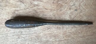

I snagged this at the flea this morning. I'm not sure if it's a chisel or a screwdriver, to be frank. The only reason I can think of for making it detachable would be to use different blades/tips in the same handle. No other shanks in sight, sadly. It has a tapered bit with a notch in it. It's very well made. No roll handle. No markings. I don't recall seeing a spring-steel tongue mechanism like this before, but I am hoping I can eventually ID it.
20211015_112051.jpg20211015_112058.jpg20211015_112112.jpg20211015_112142.jpg20211015_112203.jpg20211015_112246.jpg20211015_112307.jpg
13,458
That latching mechanism is often seen on Scotch braces and bitstock tools. The few interchangeable chisel sets are usually pattern makers, and the few I could find quickly don't latch, just slide on. There was a pattern makers tool catalog on ITCL, but not finding it now.
