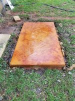

I've used Kemiko products. Easy to follow directions. You can combine colors. Base color and splashes of another color.Vapor barrier would not hurt. Broom finish is good. Let concrete cure .Use UltraSeal for top coat. I just did slabs for generator and propane tank with some leftover product.

How long to let cure?
That looks nice.
Those two slabs were kept wet for about 5 days, then waited three weeks before doing Kemico neutralizing wash, let dry, stain. If in direct sunlight, you want to do each step first thing in the morning.
The stain gets mixed with water 50/50. Put down with acid-proof pump sprayer. For the highlights I mix some 'cola' color in an empty water bottle, drill a small hole in the cap and squirt onto slab on top of base coat. The big 'splashes' are small amounts in a dixie cup, then 'dumped' from about 4' high.
I also do 4-5 coats of UltraSeal. Short nap roller. By the time you finish first coat, you can go back and start second coat.
