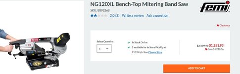

Decided this weekend that my thirty year old abrasive chop saw really does **** so I've been doing some shopping.
Think this Jet would suit most of my needs: https://jettools.com/metalworking/sawing/manual-semi-automatic-horizontal-bandsaws/414548
Probably use it vertically as much or more as horizontally.
I've already looked at used Wells/Ellis/Kalamazoo saws on Marketplace. One I don't really have the space for a big saw. Two not looking for a project. Most of the ones I've seen listed were most definitely not plug and play.
Which leads me to, should I expect this Jet to be good out of the box or will there be some adjustment to it? Are there other brands in this price range I should be looking at?

i had one like that for decades.. just last year i bought a smaller one that does everything i needScreen Shot 2023-02-13 at 9.31.53 PM.png

I have the same Jet saw, I like it. A bit slow compared to more expensive models, but works well. Moves around easily. Once you get it adjusted, you start a vertical cut and then let it run, it will shut off when finished. It works much better horizontal than vertical, vertical table is pretty small. Great value!

I have an older version of that band-saw. Had it for about a decade. Works perfectly for everything I need (which, admittedly, is not heavy-duty or even frequent use.)
Not great as a vertical saw. Adequate. No complaints when used as a horizontal saw.

This is a better saw in a more common size. Note it has a hydraulic cylinder, coolant and weighs about 3 times the one you linked.
I have a very similar model from Accura. Its a great saw.
I rebuilt a jet drill press and did not have any issues with parts. Accura on the other hand, when I call them I usually get one of two owners and my parts are quickly shipped. Good guys.

The biggest drawback to the saw you posted OP is that it doesn't miter. The mitering head versions are so convenient. Here is a link to Jet's version.
It's also offered by several others including grizzly and Baliegh. I've owned that saw and it's the bees knees in about the same footprint as the saw you posted.
Here's the Grizzly for under a grand.

I have that saw, and yes it does do miter cuts; not compound miters though.

Sorry for my imprecise language. Yes, it will cut miters in that the vise allows the workpiece to be angled relative to the head. For the other versions I linked, the head of the saw swivels so the workpiece is locked in the vise, and the head moves relative to it.
This is particularly useful in my small shop because if I have a long workpiece, I don't always have room to swing it around in different directions. Instead, I orient it longways in my shop and I just swivel the head of the saw to cut the miter angle I need.
Also, it has been my experience that the swivel mechanism on the saw head allows for more precise setting of the miter angle then the dual swiveling jaws.

Having done this many times for many decades, I can tell you that there is a huge difference between a saw that uses vice to miter vs. swinging the whole saw head. In my home shop I have a very old 7x10 and extremely limited space, so moving a 300 lb. saw to allow the cut is a giant PITA. I also replace my little 4 x 6 with a similar size vert/horiz swivelling head and wish my big saw was that versatile. So POd about that I now have a pair of 1" blade Marvel #8s for new shop (even more versatile as vertical blade that tilts 45 deg either way to miter). After all: in today's inclusive world everyone is supposed to swing both ways, not so?

The Jet bandsaws are essentially the HF bandsaws with better quality control, a different color of paint and a much higher price tag. HF sells the 4x6" horizontal / vertical for $360 vs around $800 for the nearly identical Jet. If you get a dud from HF, just take it back until you get one that works. They are very good about that.
I've had a HF 4x6" 5 or 6 years now with no issues. It has more than paid for itself just in saved cutting fees. Worked out of the box and just keeps going. I also have a 50 year old Kalamazoo 6x10" which is far and away better than the 4x6" or even the Jet 7x12" I used in my welding classes. The old USA saws have much in their favor, but even the smaller ones are bigger. Most of the USA made saws in the 4x6" class were light duty (Craftsman etc) and don't seem to be any better than the current crop from China.
It won't save you any money, but in about the same footprint I'd be considering this one from Grizzly G9742. I was able to use an Ellis bandsaw of this style in my welding class and it was great. As others have mentioned with long stock having the saw head swivel instead of the material is very handy, particularly in a small shop.
These don't have the vertical feature, but the horizontal / vertical saws are pretty meh in the vertical mode without a lot of tinkering. No better than a handheld porta-band in a cobbled together bench mount.
If you have a few thousand to spend, the Ellis saws are really nice, but they start around $3500 so an entirely different class.
