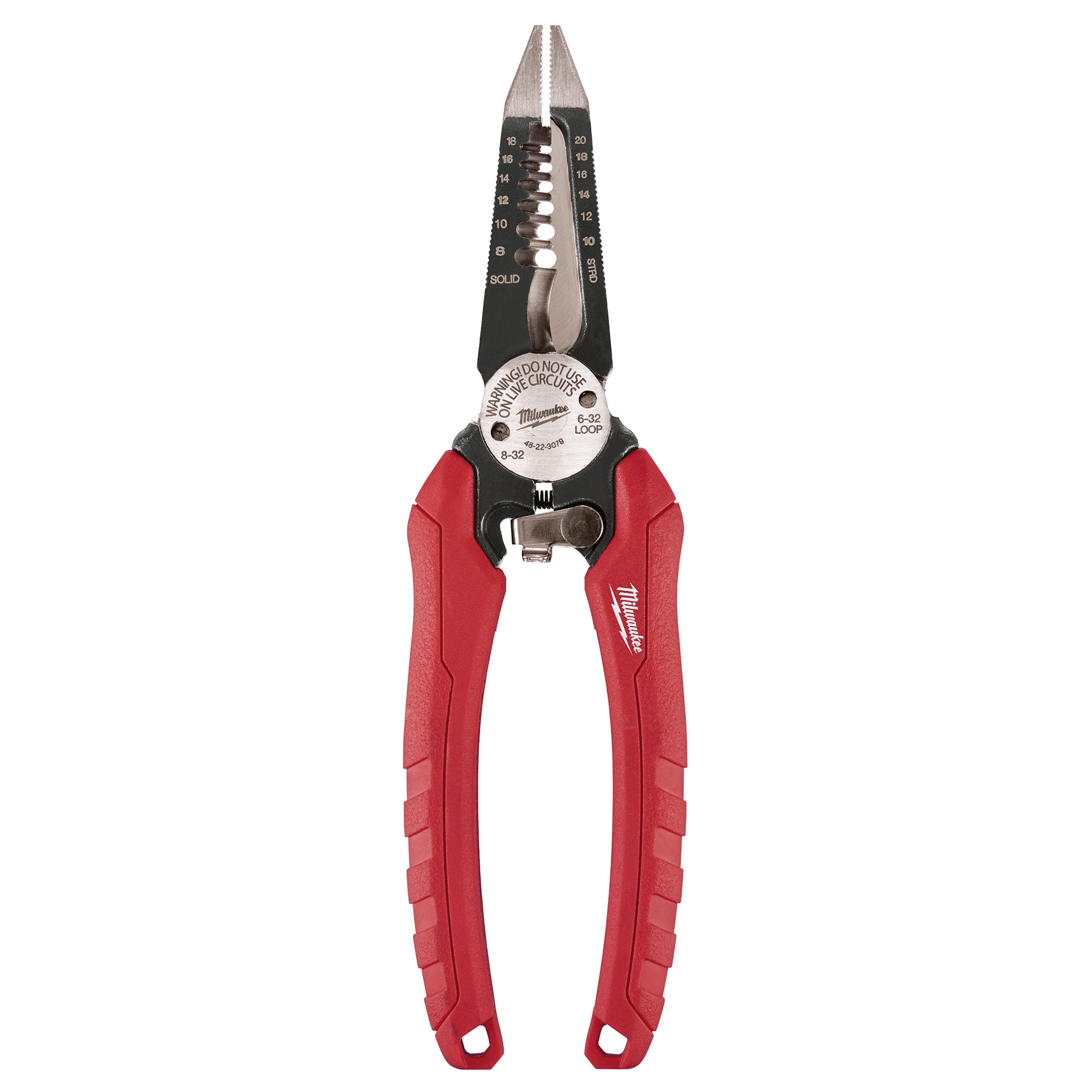

Have lots of different strippers in various boxes... i do a lot of electronics But these might be my new favorite.
Several weeks ago I got these Milwaukee 6 in 1 at depot they had a big pile of em for $15.
Serious heft not light. Very accurate, smooth and the needlenose style tip is super clutch.

If your picking up the Milwaukee 6 in one stripper crimpers. Pick up a holster for them. If you carry them in a coverall pocket, they will shred the pocket in an instant.
