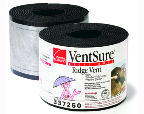

All right guys it is coming close to time to roof my garage. I want to go with a ridge vent unless some one can talk me down. This is for a normal shingled roof
There are 2 main styles I see. The plastic 48" long type, and the 20' roll form.
Pro and cons of either? :dunno: Prices are pretty much the same for my project of 40' of ridge vent needed.
Mongoose 20' Ridge Vent
images
Or 4' plastic sections

I used the 4' sections. They were a little more expensive but much easier to nail the shingles n top of without having to worry about recessing the nails too far and squishing the vent.
Keith
Any difference in brand of the 4' sections? The 2 local brick n mortar stores (home depot, and Menards) has different kinds. Photo of the 2 brands are in the first post.
http://www.homedepot.com/p/GAF-Cobr...Rigid-Exhaust-Vent-in-Black-2027000/100027903
http://www.menards.com/main/buildin...23373625-c-13260.htm?tid=-7195175333619179059
Thank you, Rob

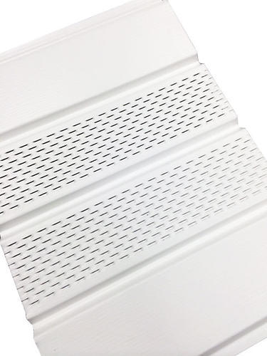

I live pretty much right in the middle of Minne"snow"ta. (Mn.) so yes we get snow. I have only noticed ridge vents on, new, new houses as it is picking up in popularity. My neighbors and I's houses were all built in early 2000's. (Mine 2005)
Correct no gable vents here. In fact I haven't seen a actual gable vent in 20+ years. Only seen fake ones that just screw to the siding. Just normal vented soffit on on the bottom, ridge vent up top. I mad the over hang a total of 23.5" wide.
Edit add soffit photo
