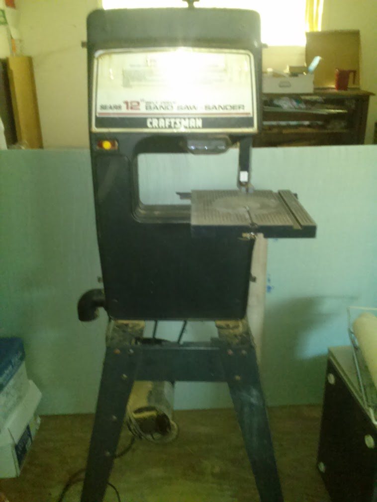

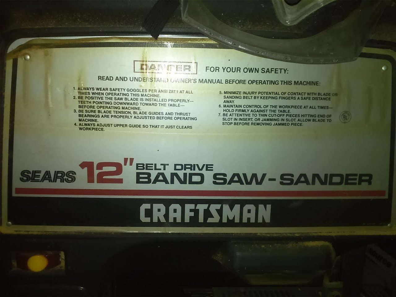

Any idea when "OLD" ended? I only ask because I inherited this:
Note that I really don't know anything about these things; I don't do much wood work, unless it's construction, which usually involved circular saws.
I'm considering selling it, but don't even know what to ask.

I consider that old, but not the good kind of old. (Ol' 'Arn = big beefy industrial or heavy duty cast iron machines built to last, typically built through the 70's before 80's imports gained ground forcing mfgr's to build cheap homeowner grade junk)
problem with a saw like that is it's only really good for hobby craft projects.
low power, no ability to add a riser, limited depth, it will never be a decent re-saw machine.
doesn't mean it doesn't have value, I would say $50-$75 tops. typically that is an entry level machine for someone dabbling in the hobby and would quickly be outgrown if someone got beyond the occasional hobbyist level.
it's like a 4" jointer or a box store direct drive table saw. better than nothing but not worth fixing when it wears out or breaks.
that said, I know lots of old guys who have built some mighty fine furniture using entry level machines like that.
with woodworking, a good woodworker doesn't NEED top quality tools if they are a craftstman with good skills. it just makes the job faster and more efficient.
not trying to be a tool snob, it's all just my opinion so please don't take offense.
