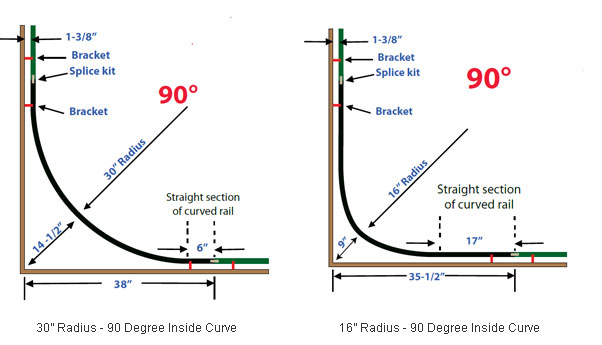

I'm tasked with designing a rolling ladder system for a client for accessing their pantry. The room is long and narrow at 8'4"-1/2"x 44-1/2". They expect the ladder to ride around the corners on the narrow end of the room. Fabbing the rail is no trouble, but I'm other than wadding up a pile of conduit scraps or something to trial and error a test fit, does anyone have a idea of how to calculate a useable radius? I know there are a ton of factors- Wheel size, rail size, distance between wheels, etc.
Prior to my being assigned this project, the customer/boss/ and installer tentatively decided on a 1" rail, and a set of wheels that are turned out of UHMW with a 1" hollow. The wheels are 7/8" thick and 1.5" OD.

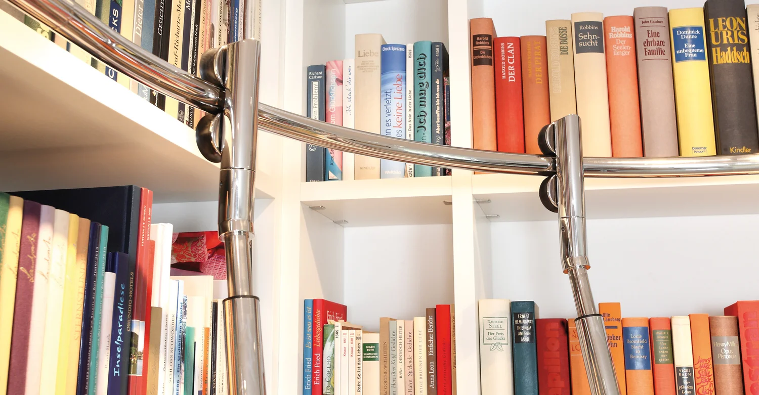

A young carpenter I know (my best friend's son, in France) built a set of shelves and a library ladder for his aunt and uncle. Knowing him, he fabbed everything from wood and likely bought the hardware. It's a traditional straight-line ladder.
Getting one to go around corners sounds doable, but kind of tricky. Maybe there's some out-of-the-box thinking to be done? Perhaps a ladder that unfolds a bit to access the short wall sorta like some small stepstools -- less than four feet really isn't that much.
I think Julien's ladder simply hooks on the rail. It wouldn't be hard to have one that could be unhooked and repositioned to the short wall in your pantry.

It might be worth considering a 3 point design where there's a single wheel up-top and a wider stance down below, or make the bottom casters spring-loaded so they can launch the ladder off the floor but the user's body weight allows it to collapse back down to hard points for extra stability. That would simplify the top's ability to turn the corner.
The alternative would be to create upper guide wheels that pivot around a kingpin sort of setup, and limit the travel to give you just enough to go around the radiused track at the top. Think of a steering linkage/front end of a vehicle but without the link, the guide wheels just pilot on the radiused track.
I'm also envisioning the upper guide wheels are a pair of upper and lower wheels that don't release from the track without pulling fasteners or pins.

Well right off, you need a couple inches on each side for the rail to stand off so your maximum radius is going to be 20".
Here's a link to a catalog of library ladder parts. They make a 16" radius section. You'll need swivel rollers for the top rail.
https://www.baersupply.com/baer/products/catalogs/Quiet-Glide-Rolling-Library-Ladders.pdf
Your ladder width and height will determine how far out it will be from the shelves. Make a scale drawing with some graph paper and a compass to see how the ladder will track around the curve.
