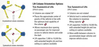

Iron-Iceberg said:
One question for placement is where will the truck sit in relationship to the lift posts? Would it be centered or would the posts be farther foward toward the motor. I would like to know so that I will be able to lift the truck without it hanging out the door like TNToy said.
A symmetric lift has a pair of arms that are the same lengths, and you typically try to get the post somewhere near the CG of the vehicle. This is usually forward of the center of the vehicle on a very nose-heavy vehicle, like a truck. And a little further back on a car like a 'vette with a nearly 50/50 weight bias. Either way, the post ends up a bit behind the side view mirrors, or roughly in the center of the door.
An asymmetric lift has arms roughl a foot longer for the rear pickup points than the front ones, and shifts the vehicle to the rear: The post is about even with the side view mirror, which makes it much easier to do things like cahnge the oil, let a vehicle down, and work on a bad window motor without having to back the vehicle up 2 feet so the doors will open.
The attached picture should help...
PATyota said:
Also, do I understand that you can lift a 1-ton truck on an asymmetrical lift, just that if you're doing it all the time then a symmetrical lift would be a better bet?
Basically, yes. I very much prefer the 9K a-symm. rotary in my bay to the 10K symmetrical Challenger next to me. Even if that bay is open, I usually pick them up with mine unless it's a diesel dually. I wouldn't want to do things that really shift the vehicle around, though... like pull the engine, ******, or front end. Oil changes and such are just fine, although on an F350 or Excursion, you've gotta fold those big mirrors in to queeze it between the posts.
