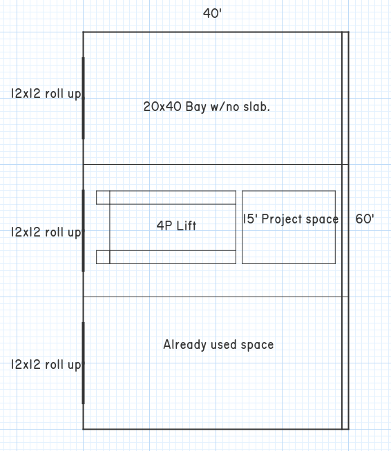

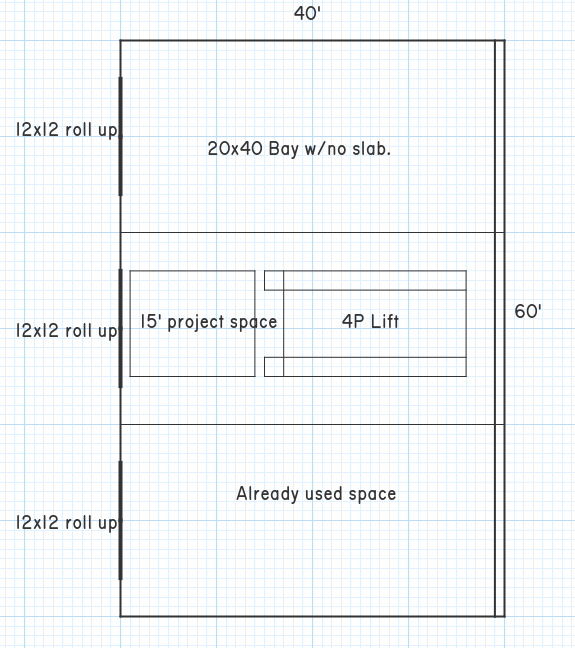

Looking for feedback on placement of a 4 Post lift (please don't turn this into a 2 Post vs 4 Post religious discussion, I have access to a 2 post if I want it). Trying to decide if I should put the lift at the front of the bay, or the back of the bay.
It's a multi use shop - agriculture, wood, automotive, welding. Not commercial. This is NOT a trailer queen beautiful man cave. Lift usage will primarily be for scheduled maintenance on ~8 vehicles, and an infrequent major project. Not storage. I've got enough height in the building that lift placement doesn't matter for my tallest vehicles. It's a 14k lift, so it's not moveable like some smaller ones.
I see value in having a slab in front of the lift available for non-liftable projects (ie: pulling a trailer or something, into the shop to work on it to get out of the sun), or even parking/storing a 13' jeep there.
The downside of having the project/parking space there, is I might fill it full of junk, and the task of having to clean it out every time I want to use the lift to do something easy like changing oil, might be a deterrent from actually getting it done.
On the other hand, if I did put the project space behind the lift, 2 of my 8 vehicles, both rock crawlers, could easily be able to drive over the lift, and park in that space for storage. But I couldn't do that for trailers, etc obviously.
What did you do? Are you happy? Why? Why not?
Lift in the front of the bay:
Or, lift at the back of the bay:

I vote for the "front" of the bay (first drawing) because most of your work will be in the front of the vehicle and you will have space for a rolling cart or engine lift PLUS when you are done working on the car you can do a "roll out" without cleaning up your tools or parts then do a return to the lift if needed.
BTW! I have a four post and this is how I have it set up so I can speak from experience.

Question: Are the dimensions listed exterior dimensions, or interior? Is the garage finished? I think I would still agree with Chuckster, but how much usable space you have might not equal exterior dimensions, and might change my view.

I vote for up front you can always raise it all the way up to gain floor space or back a trailer in to work on it. At least an open trailer. Also my opinion is any space between the lift and the door becomes dead space because as you said you need it clean/ clear to access the lift and being a owner of nine vehicles my self not including my race car. Even doing just regular maintenance is quite a frequent thing. Another point worth making is one of the benefits of having a drive on is how simple it is to throw a car in the air to glance at somthing so you definitely don't want to hinder that luxury
The building is actually a 40x100 exterior dimension building. But only 60 is ground level, the other 40 is elevated, and currently used for something else.
The second line on the right hand side is meant to take up 1ft of graph paper, which just roughly uses up the 6" wall thickness on the exterior of building. The building is not finished yet, but will be soon. Insulation, plywood walls, electrical, etc.
I placed the order for the lift today. Rotary 14k. Will be here in a few weeks.

Yep, this makes sense, and is why my original plan was to put it up front... I got second thoughts today as I was laying things out, but I think I'm now back on that track for the reasons you described. A lot of the benefit is being able to just quickly throw something up there, so I think I'd be setting myself up for failure by leaving all the dead space between the door and the rack.

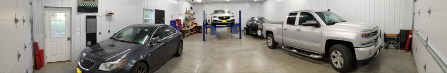

I have a 32x50 with the overhead doors on the 32 foot end (10 and 16 foot wide doors). I put my lift in the back because I wanted to fit 3 cars wide by the doors, the back needs to fit a trailer, the lift, and a work bench. Also, I usually back in so pulling an engine wouldn't leave me pinched up against the back wall. Backing in seems easier to me because it's easier to crack the door open and see where your tires are on the runway... or even easier if you have a backup camera!
In this picture the 16 foot wide door is on the right and there is room to drive onto the lift.
