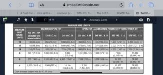

I’m about to trench a water line the length of my driveway. Next summer I plan in installing a gate and a Liftmaster csw24ul gate opener. Figure I’ll put the water and power line in the trench.
According the chart I need 8/2 wire is that correct?
That’s some pricey wire.
It’s about 400ft from my power supply to the future gate opener
Here is pic of wire size guide

That chart is too blurry to read but i wouldnt bother with it.
Whats the actual load? You can do the voltage drop calcs yourself
When you say 8/2 it sounds like youre referring to either NM-b (not permitted for outdoor use) or UF-b. UF-b is more expensive than just putting 3x THWN in pipe.

Ok obviously I don’t know anything about electrical. So just say I want to run power to this gate opener. What wire size and type should I use?
Main AC Supply 120 Vac, 4 Amps (10 Amps including Accessory Outlets) OR 240 Vac, 2 Amps
When Optional Transformer Kit Model 3PHCONV is installed in the field, operator is rated 208/240/480/575 VAC, 4.8/4.2/2.1/1.7 A, 60 Hz, 1 PH
Link to Manuel
https://www.fastaccesssecurity.com/manuals/Liftmaster-CSW24UL-Installation-Manual.pdf

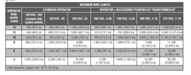

For 2a at 240v, you could run #14 copper. If 4a at 120v, you'd want #10 copper
That said, you can get #6 aluminum xhhw cheaper than #10 copper thwn and it would give you more capacity.
3-#6xhhw in 1-1/4 conduit would work. If it is a straight shot, 1" might work, but I would probably bump up
Might be a good opportunity to put some lights along the driveway, if that's something you want eventually

Great thank you for the information. Im gonna go ahead and run 1 1/4 conduit and pull the wire when I ready to install gate and opener.

The answer to your question was in the install manual of that unit... https://embed.widencdn.net/pdf/plus/cgi/g5vfstqguk/0139380.pdf?u=mcyivk - Page 17.
Most of these won't work on AC power. as they don't want you locked in if power goes down. This one pulls enough, it appears, that it can run on AC power, but I can't tell for certain. The power requirements are substantial enough that I'd think it might work without batteries, but can't tell without reading more.
