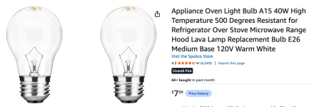

Where do you get incandescents nowadays?
My inspector said pull-chain was not code compliant anymore, and made me put a switch in the hallway to turn on the attic light. I have a pantry closet with a switch like that, and I know from experience the switch gets left on all the time. At least in that case I notice it because I see light through the door crack, but in the case of the attic, I would never notice. With 5 other people in the house, "just don't leave the light on" is not realistic. I need to plan for it to be left on for extended periods.
For now I'll install some 40W oven lightbulbs that I have on hand. If they survive in an oven they should survive in the attic. I wanted something brighter than 40W though.
If you're concerned about accidentally leaving it on, then there are plenty of bulbs with motion sensors built in, or it's easy enough to wire in a stand alone sensor switch.
Sensor switches aren't rated for attic temperatures either...

As for what bulb to use, you're in a pickle of a problem. Any highly efficient LED bulb that's rated to be used in an enclosed fixture (so it's designed to handle high temperatures) should serve your purpose in an open fixture. One with a plastic shell is what I use (so I don't have a broken glass risk). The problem is that these tend to be rated to 40C, because they're rated for 40C in an enclosed fixture (where the bulb gets MUCH hotter).
Looking at Home Depot, even an incandescent 40W appliance bulb shows a 45C rating, so if you're strictly looking to go by the book, I think you're **** out of luck here.
My take is that LED bulbs come in many flavors. Older designs were less power efficient, so they needed a lot of airflow to dissipate heat, and those sort of bulbs may give you problems (premature failure is far more likely than actually burning up). Newer high efficiency designs put out so little heat, and ones rated for use in enclosed fixtures are designed to withstand quite a bit of heat, so you should be fine. Something that draws 9W for 850 lumens in an A19 (a 60W incandescent equivalent) should do the trick, so long as it's rated for use in an enclosed fixture, AND you use it in something open.
That’s hilarious. All us older guys remember incandescent bulbs in ”trouble lights” at the end of a long cord used under hood for car repairs and other places. They got so hot they would brand your bare arm if you accidentally touched them. I’m sure those got to 100C or hotter.
