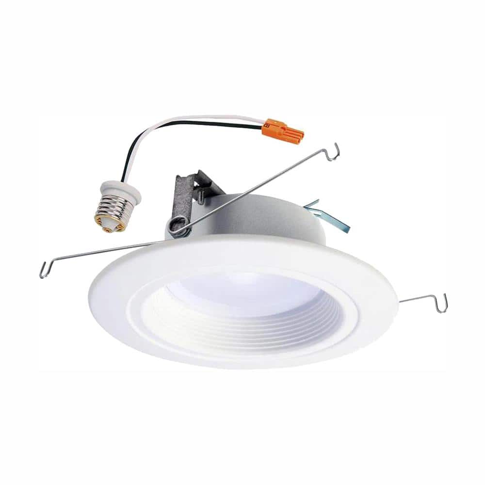

I am slowly progressing on my shop. I have a 20x24 “bar” room inside of it. I want some sort of can style light inside or something resembling a can light for lighting. What’s the best route to go? I’m over whelmed with all the led options and stuff…..

These are what I use. The newer style trims are nice because you have the choice of different colors out of the same trim. If you dont like the color just pull it down and slide the switch on top.

I have probably installed over 30 of the 'wafer led' type lights in my house. Since they are no thicker than 1/2" they can virtually go anywhere, as long as there is room to stuff the attached electical box up into the ceiling. That means if your planned layout happens to fall under a joist or something - no problem. The newer ones come with a 'slider' on the box where you can pick the color temp
