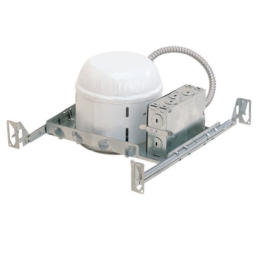

Planning ahead on my home build. Over my shower, I would like one or two light fixtures and a ventilation fan. Ceiling will be 8 feet.
Are there any special considerations or suggestions on what to use. I would like them installed directly over the shower. Nothing fancy, I am a simple plain man. I see around the Internet using a typical light box with a moisture sealed ring cover and then I see special shower fixtures. Not sure of the pros or cons on each.
I was looking to go this route but am open to suggestions...
Halo H7T:
Cooper Lighting 70PS 6-Inch Wet Location and AirTite Listed Trim:
For the fan, I was going to use this...
Air King BFQ 90 High Performance Bath Fan:

I have a similar setup in my bathroom. I have a recessed can with shower/wet location rated trim installed directly over the shower and a light/exhaust fan combo installed in the center of the bathroom. The light over the shower provides more than enough light for the shower and the light on the light/fan combo makes enough to light the rest of the bathroom.

I used these from Depot, they are rated for wet locations, for a 5X5 shower, I used 4, they use up to a 50W halogen.
http://www.homedepot.com/h_d1/N-5yc...splay?langId=-1&storeId=10051&catalogId=10053
They are fairly inexpensive. Also you can add the rails/pan for a couple dollars more, for new construction. See the link for links to those.
Here's one you can see it in the corner. I also added a dimmer which in retrospect was a nice touch.

Most codes do not allow for exhaust fans in the shower / tub area. Technically, they are NOT designed for moisture removal, but for 'stink' removal alone. A good exhaust fan placed in the center of your bathroom will do both jobs just fine. I usually have the electrician install a switch that operates the lights and the fan, with a delay timer built in. Separate switch for vanity lights.

It's been a while so I don't remember, but double check your instructions when installing them over a shower space as it may call for a GFCI protected circuit.

Thanks to all for all the feedback and suggestions. The fan will probably not be directly over the shower. I will probably install it near the shower to vent out as much steam and moisture as possible.
A GFCI breaker will be used and I like the timer idea as well. Thanks again for all the input and links.

If placing the fan directly over the shower, it indeed DOES need to be on a GFCI. Sometimes I like to offset the fan about 2-3 feet off the shower door so we don't have to go to the hassle of GFCI'ing the fan; also you don't get the chill of moving air over wet skin.
The light does not need to be on a GFCI so long as you have a fixture rated for such use or a approved cover. Panasonic fans IMO are some of the best. I typically use Panasonic for steam removal, Broan in power rooms where a little extra noise is sometimes needed.
