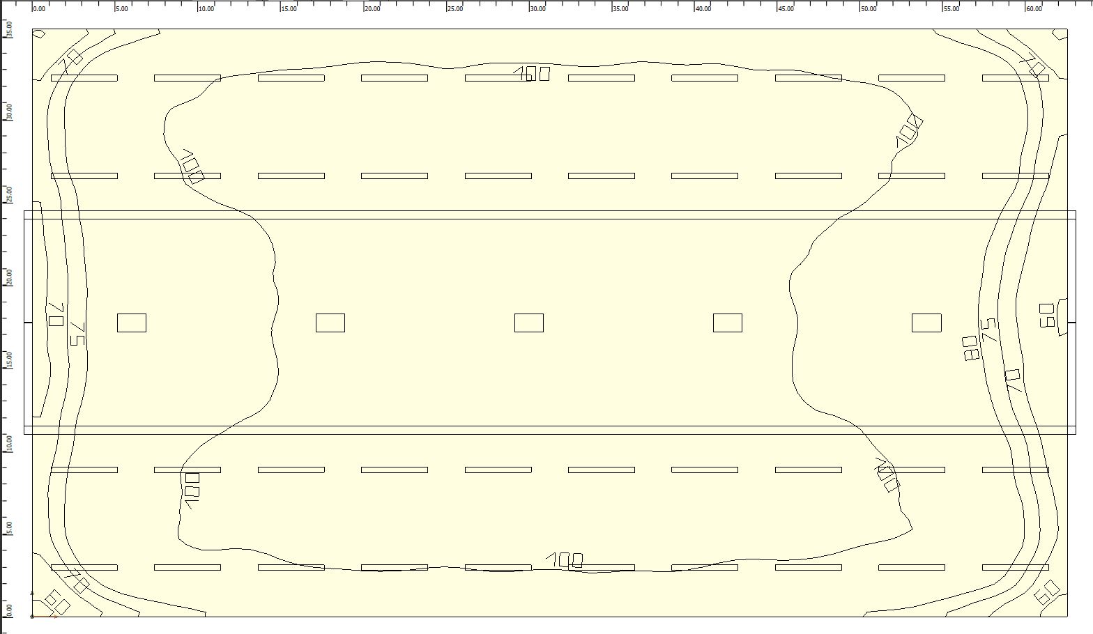

I'm in the middle of converting a horse barn into a workshop. The barn is an L-shaped pole building with a raised center aisle down the long arm of the L. The long arm is 36'x64' and contains the workshop. The roof is a 3:12 pitch and the framing is all exposed. Ceiling height is 9' at the wall coming up to 12' at the center aisle. The center aisle is then another 3 or 4 feet further up.
I'm looking for 100 fc illumination at bench height (3'). The walls are shiplap painted a beige (almond?) that looks like the same color as light switch covers. The floor is bare concrete. The ceiling is insulation faced with white paper.
I started out with "The Best Light Fixture Ever!" recommended fixture and used those on both sides of the raised center aisle (the red fixtures in my plan view). I then added some 13000 lumen high bay fixtures down the middle of the center aisle. The framing makes it pretty desirable to make the lighting observe the 12' repeat down the length of the workshop.
I'd love to get some advice. Right now I'm at 65 fixtures which is a lot more than I expected, but from looking at all the layouts people have posted I think I'm in the right ballpark. I've put together a model in dialux evo and had fun playing with it, but I don't have any idea how to take it further -- what sort of things should I be trying to get the results I want (bright uniform light) without having to spend forever installing fixtures?

I petered out on my modeling once I had captured the stable spaces. The full building has some funky roof planes -- the roofs themselves are straightforward, but then they intersect at right angles and the intersection (the back of the valley) is exposed on the inside, etc. The strange looking monolith in the SE corner (where the two arms of the L meet) was originally a caretaker apartment and is finished space. I'm not changing the lighting in there for the time being, so I just skipped any attempt at modeling it.
I've started playing with reduced light arrangements given all the feedback that 100 fc was a really high target for this much space. It seems like I can chop down the number of fixtures by about half and still have a fairly uniform layout around 75 fc, down from the 125fc or so I ended up with previously. Probably a good tradeoff unless I'm much faster at installing fixtures than seems likely.

Here you go Telemattic:
96fc @ 30" workplane.
Qty. 5 Alphalite Slim Linear LED High Bay, 2 Foot, 14,410lm 110 Watt $91.25 ea. (link)
Qty. 40 of the Best Light Fixture Ever (80 bulbs)
I redrew the space removing all openings, windows and textures.
Used standard 70|50|20 ceiling|wall|floor reflectance.
Dialux PDF report (link)
