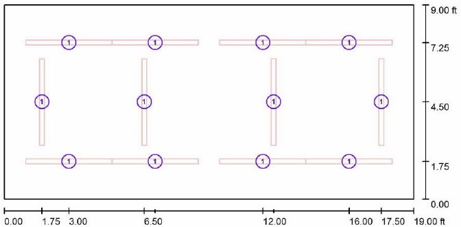

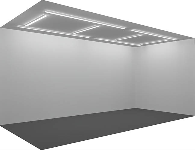

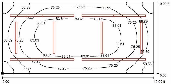

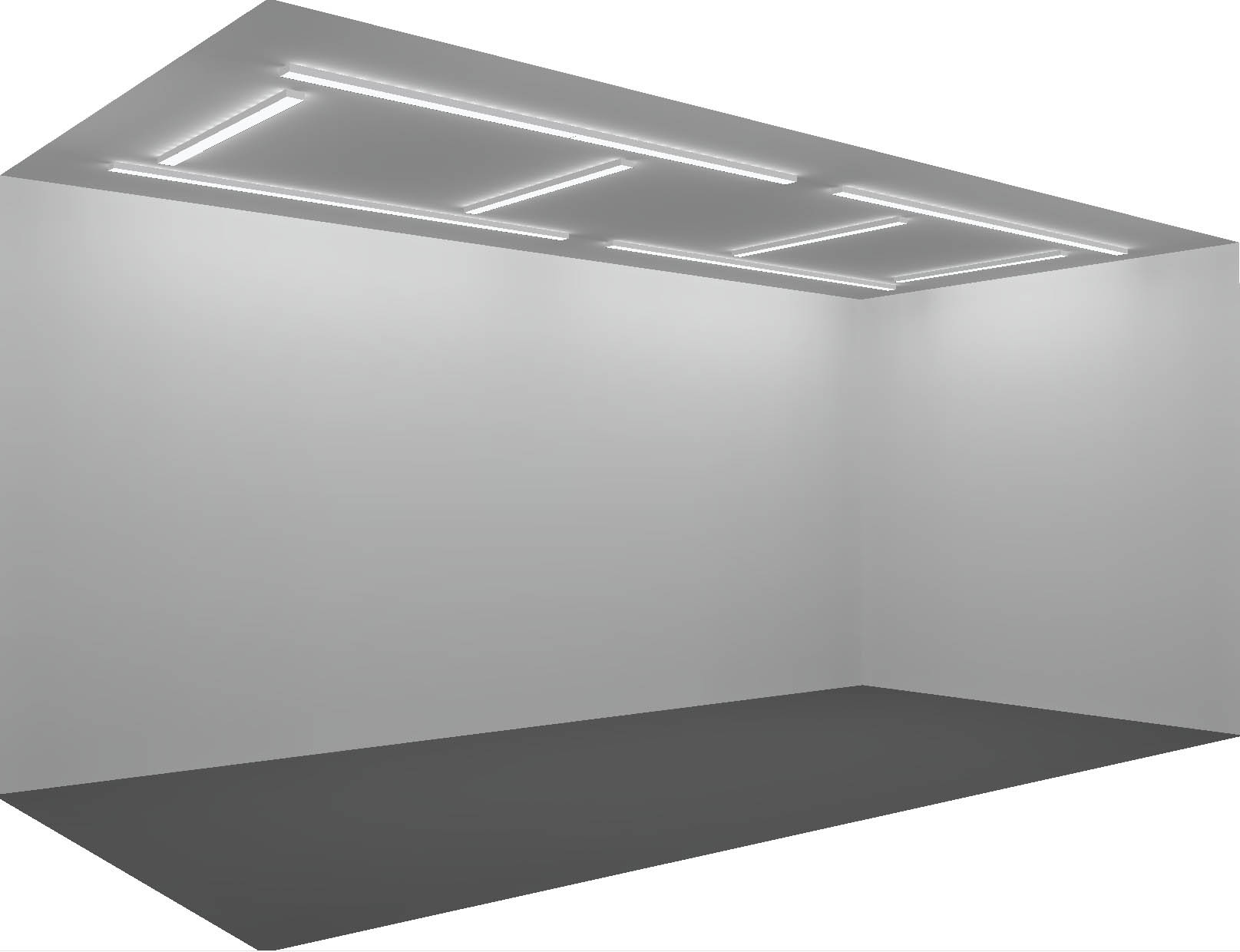

bczygan 9x19x9
Don't think of it as adding light fixtures to a room, think of the room as one large light fixture. Obviously, your "light fixture" (room) is in dire need of repair. Fix the ceiling - paint it ceiling white and paint the walls satin white (at least the top 4 feet anyway) as this becomes your fixture (room) reflector.
Get Qty. 12 of Cooper Metalux SNF132RC $19.98
Suggested Lamp: Qty. 12 Sylvania 22026 (5000K) or 21767 (4000K)
5000K Fluorescent T8 Fo32/850/Xp/Eco3 available at globalindustrial.com for $2.93 each.
or
4000K Fluorescent T8 Fo32/841/Xp/Eco3 available at globalindustrial.com for $3.37 each.
Install like this:

Some questions and comments.
First, what software (Online or off) are you using for your charts and layouts?
Second, I already have 8 fixtures. The ceiling will be redone. I'm going to tear off the other half and run a gas line and some electrical up there and insulate, then either drywall or use white painted steel panels. But for now, I'm getting an adequate level of light for general illumination. My layout is like yours, minus the 4 in the middle. If I added those, I have no doubt that the levels would come up, perhaps to the levels you show.
I have corded because they are easy to move around and reposition. Also, the fixtures and lamps were bought at Lowes with $10 off $50, so fixtures ended up costing about $15 each. I'm not so concerned about the ceiling reflecting, so having reflectors on the fixtures is OK. And I love the 6500K lamps I'm using.
I do appreciate the cleaner look of the ceiling mounted and hard wired fixtures though. Even lenses would make things look more finished. Even recessed.
I might pick up 4 more to try your layout. I can always use them elsewhere if they are too much. That's the fun of a small garage. Trying different things doesn't cost too much.
