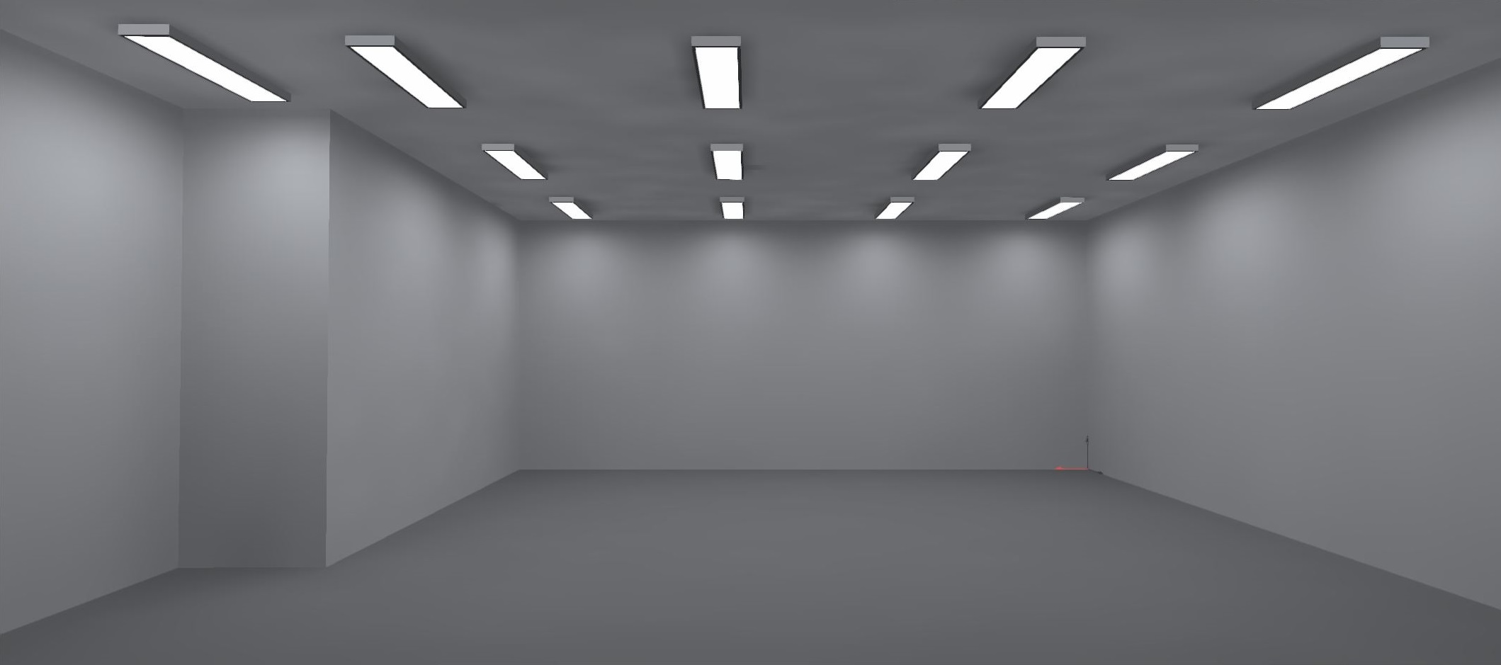

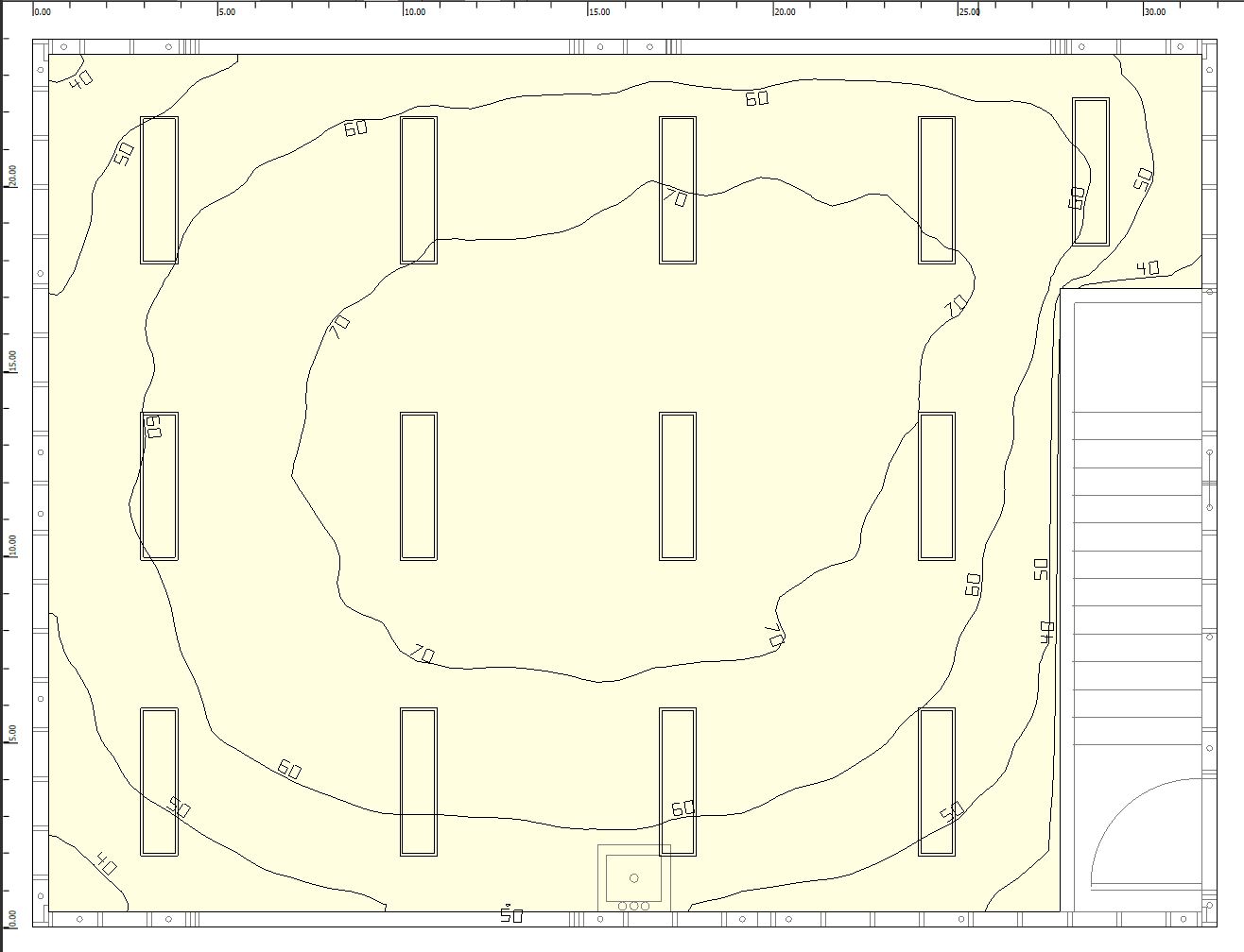

Suggestion 1:
Qty. 13 fixtures (or 12 if you eliminate the one behind the stairs)
1ft. x 4ft. Flat Panel LED 5000 Lm 40W $33 (link)
with
LumeGen 1x4 LED Panel Surface Mount adaptor $24 (link)
Avg fc @ 30" workplane = 63
Total Cost = $741
Dialux Report (link) dimensions on pg 3 are from interior of walls.

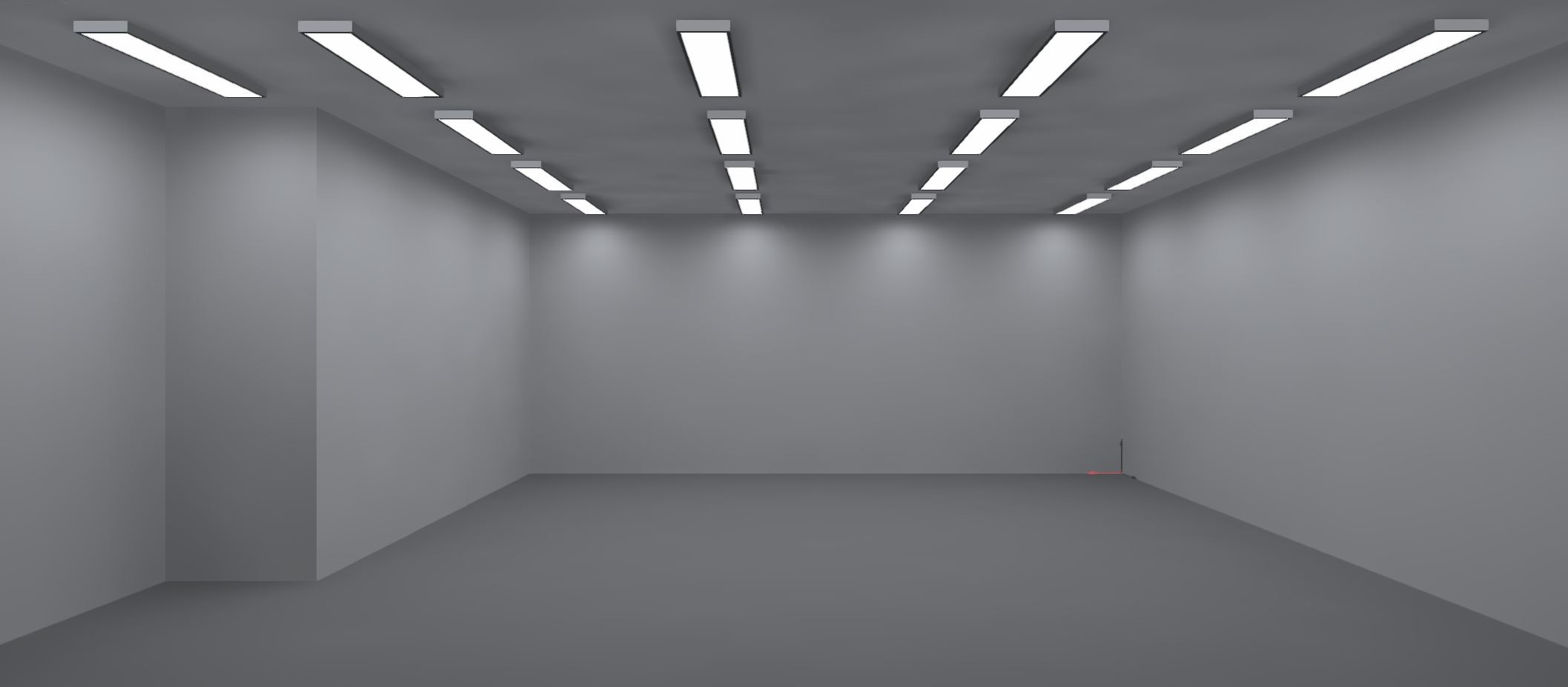

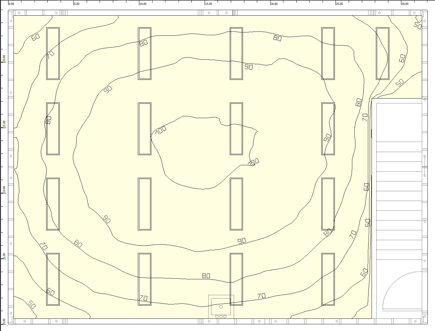

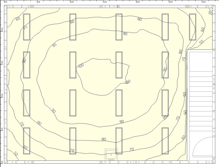

Suggestion 2: (My recommendation)
Qty. 17 fixtures (or 16 if you eliminate the one behind the stairs)
Same fixture and surface mount adaptor as above.
Avg fc @ 30" workplane = 83
Total Cost = $969
