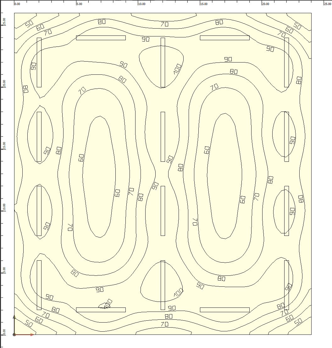

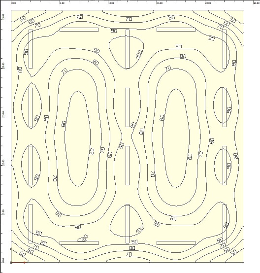

Here you go:
See post 1 (link) of best light fixture thread for lamp and housing links.
Qty. 32 of LUMEGEN LG-4T8-22WBB-SM50K 2640 Lumens per bulb
Qty. 16 Maxlite LSS2XT8USE4803 housings or equal
Approx Total cost: $470
Avg illuminance @ 30" workplane = 80fc
Surface reflectance used = 20|20|20 Ceiling|Wall|floor
Dialux PDF here (link), see page 2 for dimensional fixture locations.

With a little creative carpentry you can recess the 12 parallel to rafter fixtures between the rafters. The other 4 could be changed to 1x4 flat panels (link) which would only protrude 1/2" if you can figure out a way to hold them up there.
Alternately you could do the exact layout above in 16 1x4 flat panels at a cost of $600.
