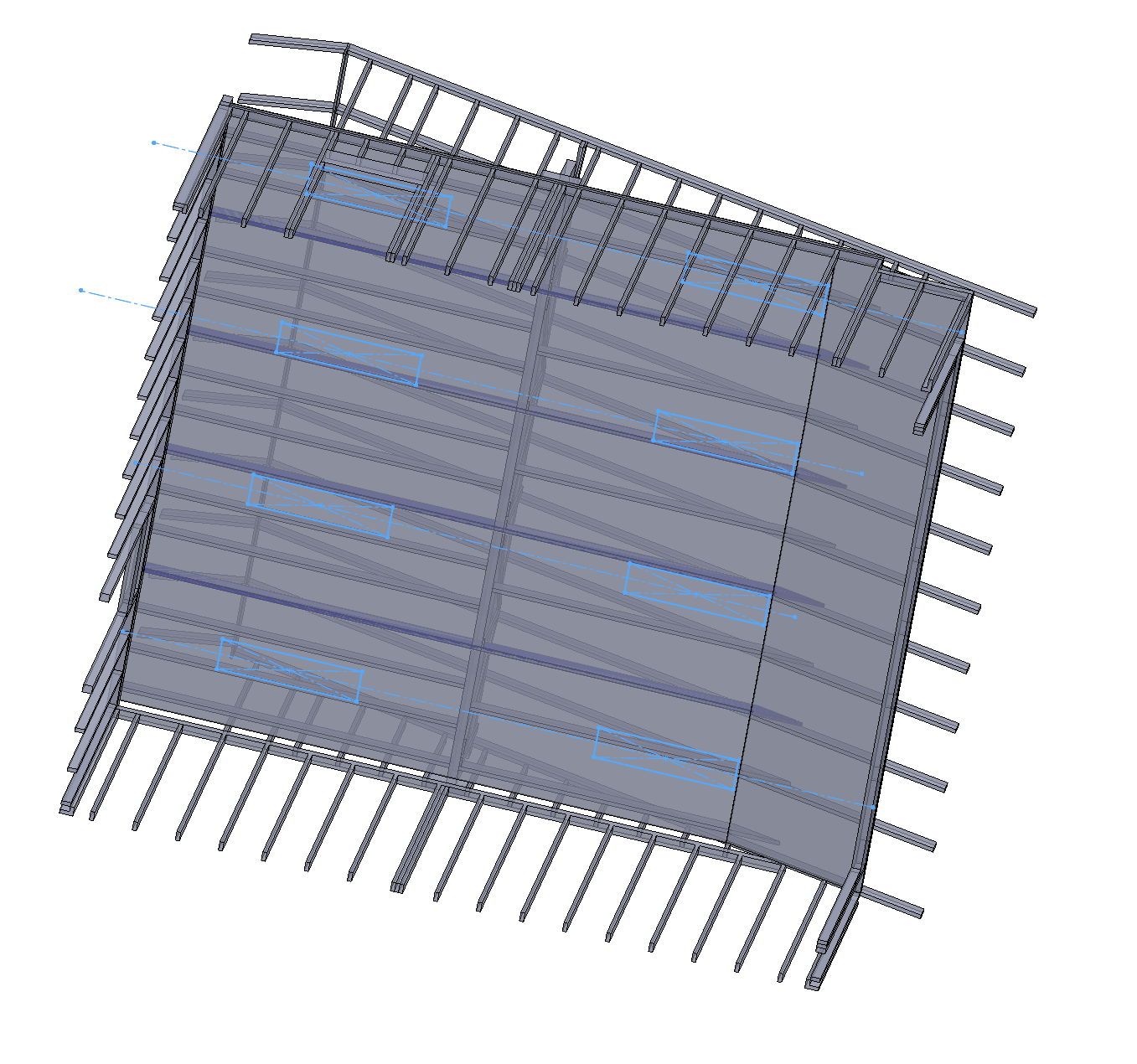

Thoughts on this layout/fixture combo? I want the flush look (wife prefers it too) and saw a few others do similar things.
Framing looks like this. Joists farthest from garage door are on 16" centers and the front joists are on 24" centers. All lights/joists would be run longitudinally down the garage in the 22.5' dimension. The troffers would run parallel to the length of the garage.
Proposed layout:
Edit: With Platonic's reply in the other thread it looks like the beam will interfere with the center column of lights as proposed. I would prefer to avoid the surface mount ones for consistency. I have had a hell of a time finding the surface mount ones that don't require a 2+" thick surface mount install kit. I am also wanting 5000k fixtures, which has made my search even harder.

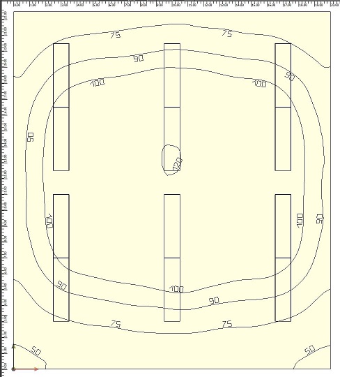

Here is the ceiling layout with 8 lights instead of 4. This is only 72 fc.
Any help is appreciated, thanks!

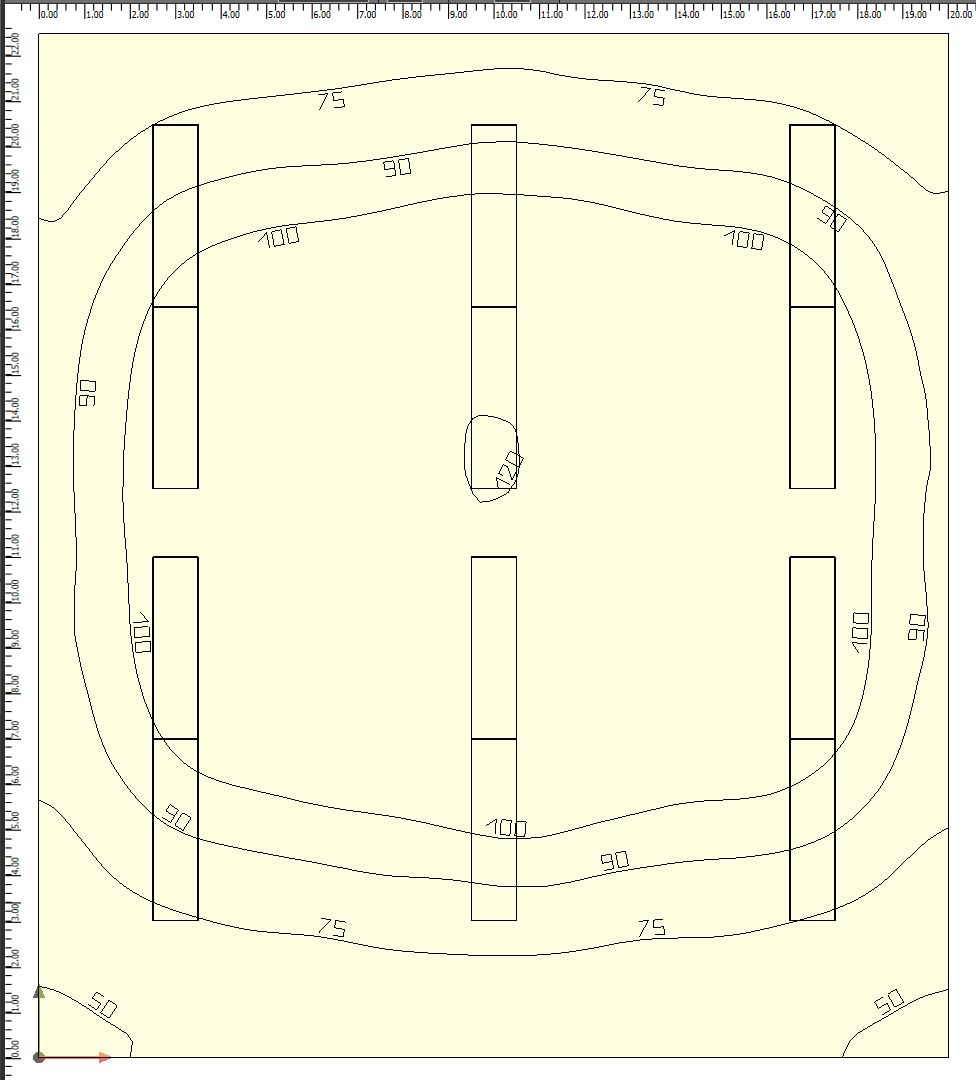

How about something like this:
Qty.12 1ft. x 4ft. Flat Panel LED - 40 Watt - Dimmable - DLC 4.2 Premium Approved - 5000 Lumens - 5000K - LumeGen - $33 ea. (link) - Total $396
pic linked to larger image
Dialux PDF Report (link)

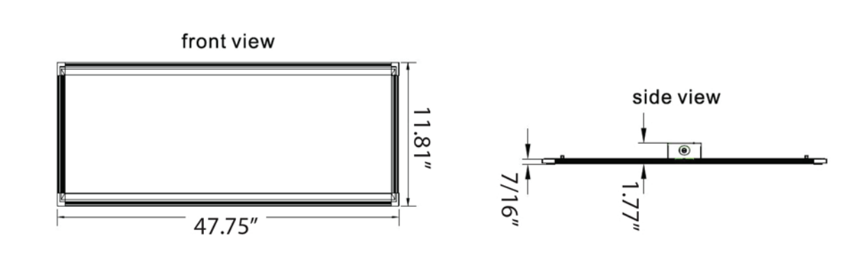

Sivart321 - The box on the back is the LED Driver. I see no box on the back in the literature of the 2x2 and 2x4. I've never seen an LED edge lit without a discrete driver. Keep in mind you will still need a junction box attached to the back of the 2x2 and 2x4. The 1x4 does not require a junction box as the driver enclosure performs that function.

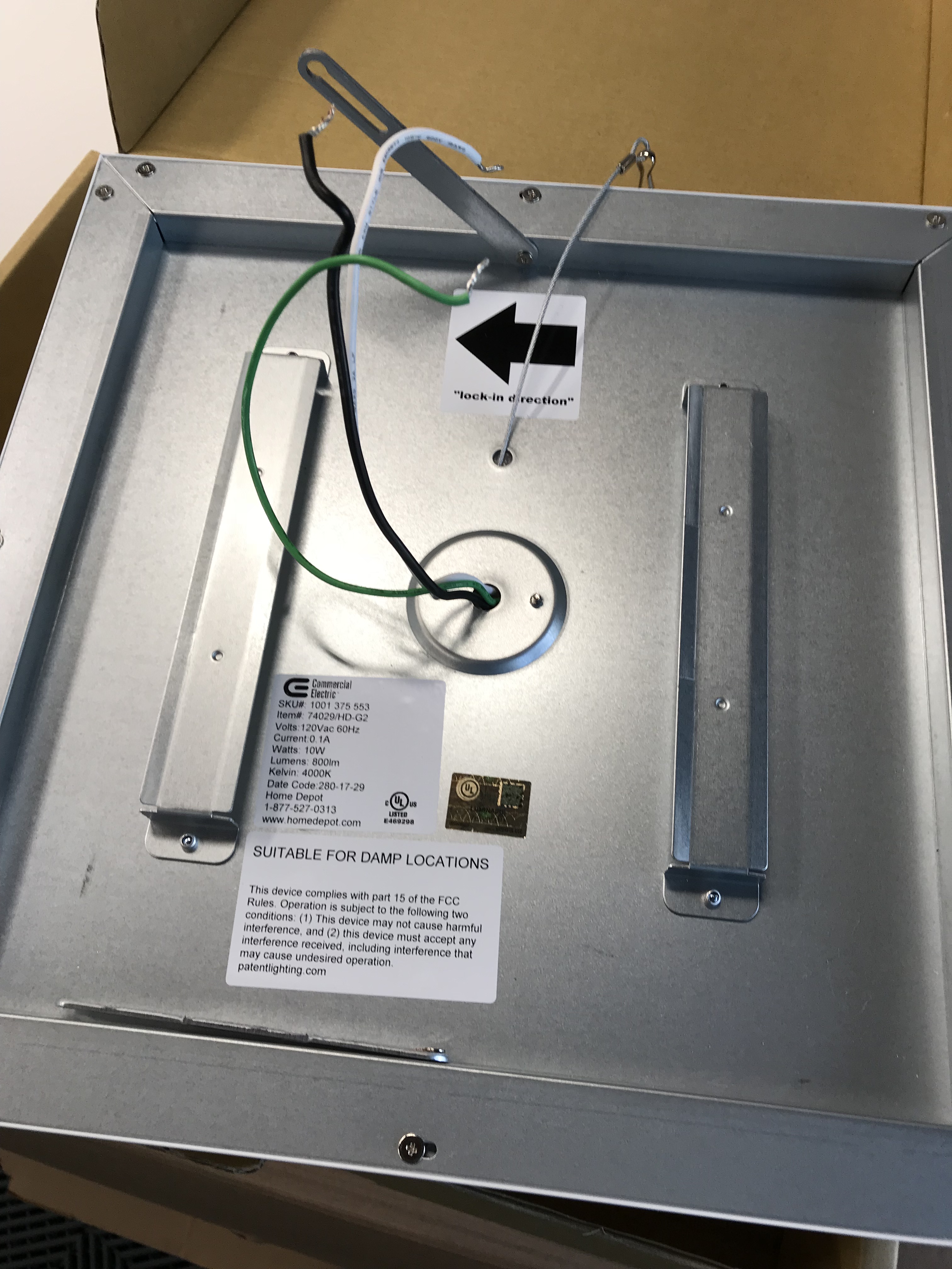

Commercial Electric makes similar panels and I have one in hand that has a driver inside the panel and is still edge lit. Panel uniformity is still good. I imagine the LumeGen is the same thing and contributes to the higher cost vs the one you suggested.
I understand the one you have suggested has the driver in the box and this other one would require a junction box. I was only mentioning this other one because it includes the flush mount installation kit and looks like it would get me a lower profile installation overall.
Your other suggestions seem more up my alley and would achieve the true goal of going totally flush. I had not seen the drywall grid adapter kits. Those look perfect and should give me a ton of options for framing while letting me use the cheaper panel you suggested.

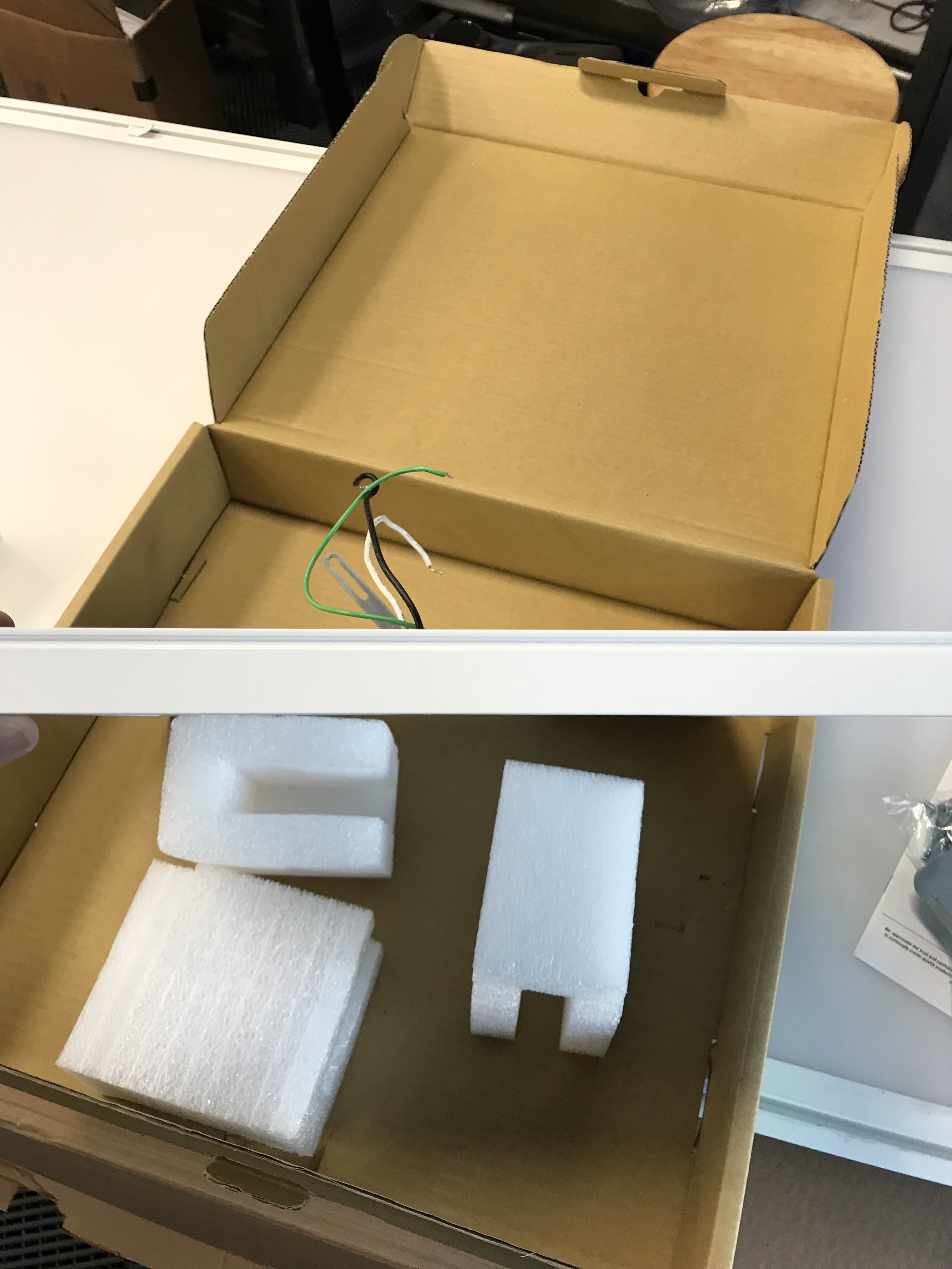

All I know for sure is that commercial electric sells a panel with no LED driver box on the back. This series can be directly wired to 120v. It also has a nice flush mount with a hinge/safety wire to prevent it from falling on you when you remove it. Not bad, but it only comes in 4000k.
Example:
http://www.homedepot.com/p/Commerci...-Lit-Flat-Panel-Flushmount-74031-HD/206040708
The 1x1 light I bought to verify:

OK, I get it now. The flat panel edge lit fixtures that don't have a discrete driver are thicker so they could build the driver into the frame. Thanks for posting pics.
I believe the LumeGen 2x2 and 2x4 likely have internal drivers since they are over 1" thick.
The LumeGen 1x4 is only 7/16 thick.
