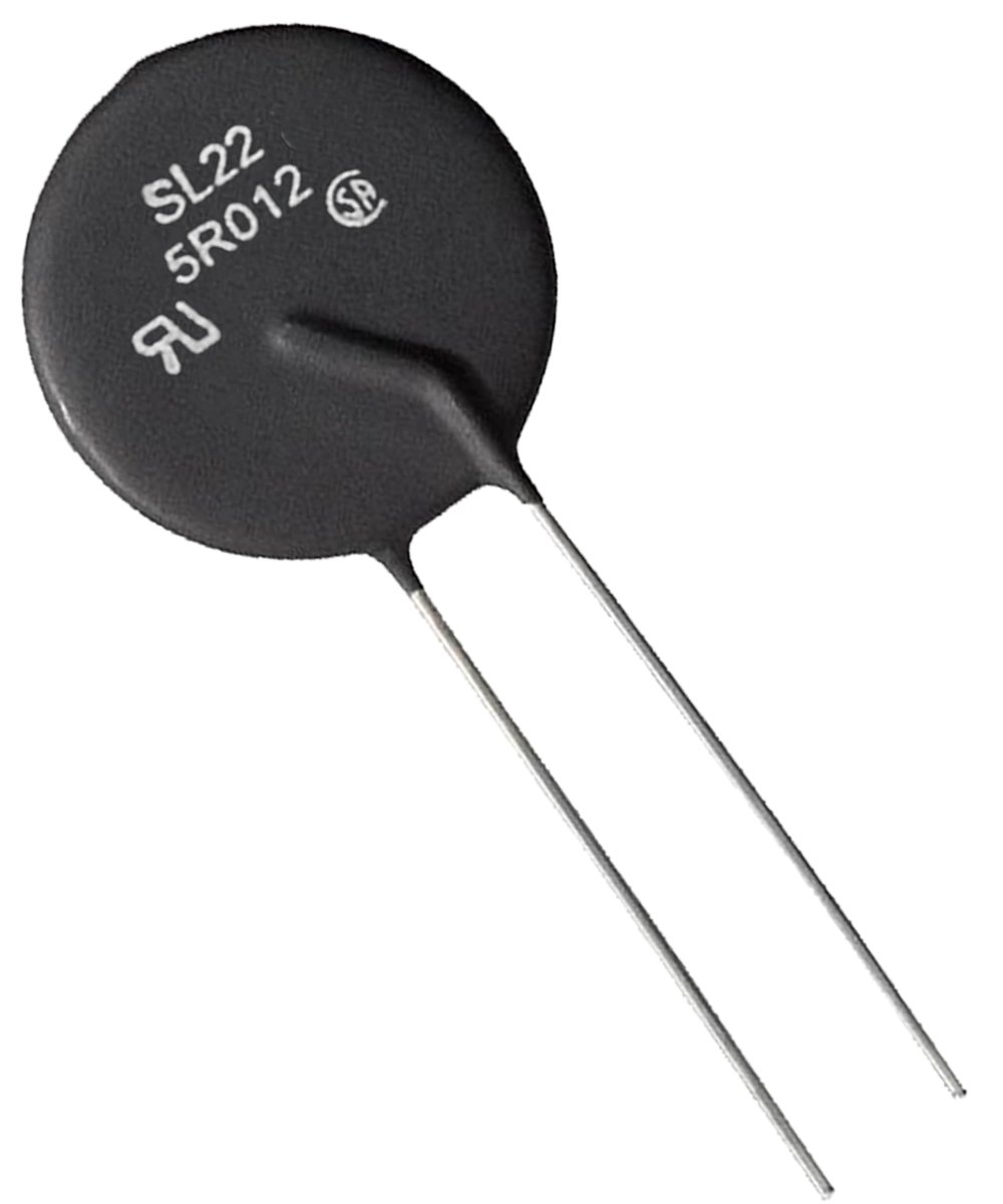

Crazy storm w/ lightning came through (again) -- couple hours ago. Heard the hit - lights went out twice - back on. On investigation: All the ground fault breakers tripped ... noticed a few others including the gas dryer's breaker. Tripped as I tried to reset -- smoked (always bad).
On investigation -- The power line cord splices in two as it enters the unit. One goes to the guts ... the other to the transformer that runs the electronic controls. The control harness has this red (guess capacitor) connecting line and neutral (it's not on the wire diagram?)
Any idea what it does? Its a 120v transformer. Diagram says 10v out
Also:
Most of my Lutron dimmer switches also blew (20) -- as well as two cable boxes/ TV's and my very good business printer in the office (naturally the old one is fine)
It seems everything else is working -- including my two newish AC systems .. I hope.

Could be a mov or a filter cap. Need more info, any identifying numbers, letters, and features?

The blown component is a metal oxide varistor. It did its job absorbing the surge. it may have failed closed (shorted) though. It happens.
They are pretty cheap to replace if you have any electronics places nearby.

looks to me like a thermistor or a fuse - but it could be a Varistor as suggested. Do you have insurance that covers lightning damage? I'd just let them pay to have it fixed or replaced. You might fix one part then two weeks late the motor burns up because a winding arced over. If a thermistor blew it may mean the console is shorted.
From online "A varistor is essentially an open circuit until its breakdown voltage is exceeded which point it begins its resistance drops steeply. A thermistor is more of a temperature sensitive resistor; it's not "normally closed", it's a resistor."
Varistor:
Thermistor:
It has an H then a J4 with 130L20 under it . when I google the lower number the thing that comes up is correct -- is the H J4 the model?

Your picture shows what looks like a mov. They are used to clamp the voltage to a safe level for the components downstream. They have joule rating and yours was obviously exceeded.
You could cut it off to test the dryer.
Take pics of all damage.
Y
So it is functioning as a surge protector ?
before you plug the connector back in check the voltage coming out of that transformer to be sure it isn't shorted and allowing 120V thru to the panel. It may have been there to protect the panel if that 10V transformer failed to the high side.

Yes, you'll find them in many powerstrips, etc. The problem with them is how big of an energy rating to provide. Real hard to measure lightning. Hopefully it (alone) took the hit. You can find them on amazon of course......just what size to put back in?

So is it designed to trip the breaker to save the appliance?
I removed the what ever it is .... and checked the transformer. The transformer is 10 volts across the middle to each terminal -- so 20v across the coil. That's correct ... so I guess it did not damage the transformer.
But -- the unit did not come to life ... guess the board is toast.
I'm going to check the motor and gas relays ... see if they turn on the motor and start the gas cycle. If they work I will spend 10min and check the control pad. If all of that is good it may be worth getting a board. Used they are around $100 -- someone has a NOS for $165.
No. If the only thing you did was clip the smoked mov out of the ckt, then I would say the MOV internally shorted as a result of it trying to clip too much energy. The surge was way too large as the downstream items have failed also. An MOV with a higher joule rating may have helped.

It sounds like it just there for protection ? It's only on the line going to the transformer that powers the controls.
The actual dryer works off two relays -- one for the motor and the other for the gas circuit. When I jump the relays ... both operate as they should. The control is just cycling the relays.
My guess is it blew out the board -- I don't see it hurting the keypad .. but it may have done something to the display?
It may be worth trying the $160 board ... it's cheaper vs getting a new SQ set at 2k+

The phone system survived .. we use Fios. No cable line outside. I'm wondering if the dryer got sapped through the ground ? All AL vent to outside?
My guess is the Fios boxes got killed from power.

The dryer is gas -- it does have a metal vent. And it's a bit odd -- the vent had to exit the house under ground and go up -- it's SS pipe. It's not very long of a run.
If the power went through the ground ... that could be it.
Yep. It's a varistor that did it's job. If it isn't totally burned, there may be markings indicating it's voltage rating.
