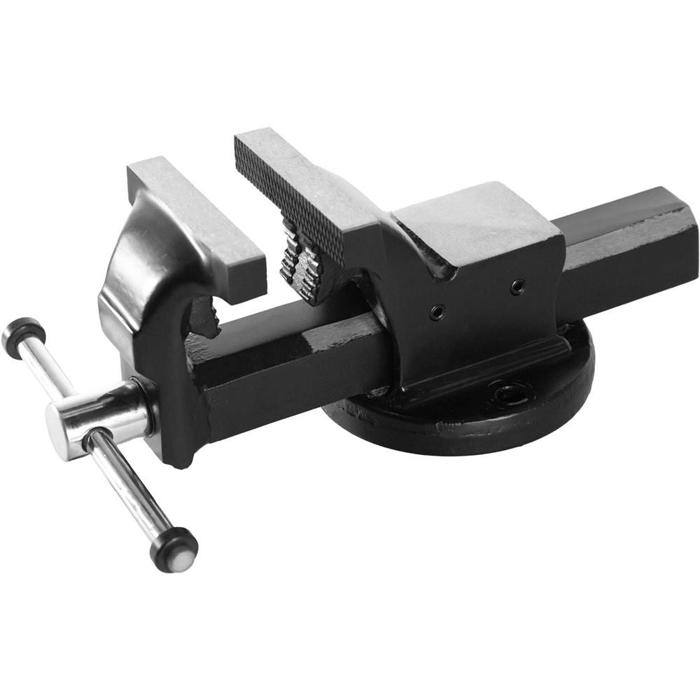

I have a small work bench for working on guns and reloading ammunition. The quick change mount I use for reloading presses has a plate for a vice with an 8x8" bolt pattern. I'm looking for a lightweight vice to bolt on there. I don't need pipe jaws or anything heavy duty. I have one of those in the garage. This is just for holding stuff to wrench things on and off.
I was looking at the Wilson super junior 4". No idea if it uses an 8x8 bolt pattern though. I could always just drill new holes in the mounting plate.
Or maybe even something made of aluminum? I'm not going to be beating on it for sure. It'll mostly have soft jaw pads in it too.

The 8 x 8 bolt pattern is huge. But like you said, it’s easy to drill new holes in your old plate.
If you like new stuff, go ahead with the Junior. At around 100 bucks it’s a good choice, Another way to go would be to get a vintage American made vise and spend some time cleaning it up, lubricating and even paint it your favorite color. A 3 inch jaw model would be fine for what you say you’d be using it for.
Post in the wanted section of GJ and I bet you’ll get a few responses. I have a few to choose from that I would send to you for $100 or less.

I was about to buy the Wilton Junior, but read the amazon reviews about how terrible the swivel feature is. 2 bolts and ride in curved slots, lots of play. Hmmm.... Maybe I need to keep researching.

You might be better off with a fixed position, non swivelling vise. Do you REALLY need to swivel it? Fixed base vises might have been more popular back in the old days. 😎
Nope!
Also just measured my vice plate- it's more like 6 1/4 x 6 1/4, not 8". So maybe it's standard for vices?
I just looked in my garage and I have a 5" wilton on my work bench. So it doesn't need to be that big and I don't need pipe jaws either. Nor a flat anvil area on the back, although that seems standard.

There is no standard hole arrangement for bench vises. Lots of variation. Expect to drill new holes or if that’s too ugly, make another plate with holes to mount your upcoming new vise and then mount that plate to the existing one. Then you wouldn’t have exposed holes, Does that matter a lot to you?

Yeah that big old Reed is too big. The Grizzly looks like it'll work and the price is right too.
So you can see what I'll mount it on - this stand has quick change base plates- one of which will be the light weight vice.
I also have a Panavise sitting on a shelf and they make a base plate for that. But's just a little bit light weight. I don't need it holding an AR-15 rifle in a mag well adapter to be worked on.

Yost ADIs are light. You'll have to come to grips with nothing matching your bolt pattern.

Have you looked at adapting an older Zyliss / Z-Vise to fit your application?
Very lightweight, but designed to clamp to the edge of a bench..

I hope you have had better luck with these than my coworkers. They described that vise as a “semi kit“. The movement had a pretty rough feel.
I have the non-clamp version, 4" swivel base vise--- SBV100. Made in Czech Republic. The swivel movement is very rough and only swivels about 35*-45* either side of center. It only opens about 2-1/4" also. I wouldn't buy it again especially since it commands the Wilton "premium" pricing along with the rest of their stuff. Didn't appreciate the amount of machining grit inside. Good solid little vise for what it is but I wouldn't have it for my only vise. The above mentioned Yost ADI-4 is more versatile (swivel range and opening) and a steal at $44 if you want a smaller vise.
