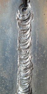

These are not perfect but general demo and could be greatly refined with a little practice. The 1st is DC and the first pass is a simple stringer up the joint then covered with a second weave. Note in pic 2 the tendency to hump in the middle, AC wants to sag and have to use a weave with the 7018 to keep it from drooping. Way more difficult and really operator dependent.
Even with the whip and pause of the 6011 in the 3rd, ac would want to drip or droop in the middle instead of flatten out.
I have my AC/DC, had it on AC a couple times in 35 years, 1 being that bead in pic 2. You could and should set it on DC+ and take the knob off and toss it so you are not tempted to fool with every setting on it.
