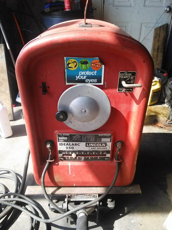

Could somebody with an old style idearc give me physical measurements front to back and overall height? I'm thinking about picking one up, but want to know its overall size to see if it would fit under my work bench. I know they are heavy so I don't need to know weight. Thanks.

Idealarc 250 came/come both ways: square & tombstone
Which are you looking for?

A side note, I've had both the Dialarc and the Idealarc in the past. The Lincoln blows the Miller into the weeds. I wouldn't bet on it sitting very long.

I paid around $400 for mine and took a full day round trip to get it. It was well worth the effort, these things weld so smoooothly. Be prepared for heavy lifting. IIRC, it weighs about 360lbs.
Mine came with fairly short leads which worked for my welding table, but I wanted to reach out to my driveway. EBT has by far the best prices on high quality cable, I bought 125' of #2 cable. Now I can reach way out, which is really nice. I put racks on the wall to store the cable.

You might be surprised how much you use a high quality stick welder after you get one. One thing to keep in mind is the Idealarc 250 is a much better, higher quality and more capable machine all around, than a run of the mill Lincoln 225 tombstone. Paying a little more for an Idealarc is money well spent.

While I can arc weld pretty good, I simply don't do it much, even at work. I prefer to wire weld. For what I do at home, my 211 is perfectly sized for me. That said I know it has it limits. Main reason I didn't buy a 252 right away is I figured for what the 211 cost, I could pick up an arc welder too for less than a 252. Been watching for a newer thunderbolt for about 2 years now and the few that pop up, $600 or so. I see this idealarc and I talk to a buddy who use to fix welders for Miller. I ruled a dialarc out years ago. Besides size, they don't run great on residential power. Buddy says an idearc will be happy on a 50 or 60 amp circuit. So makes me think go big.

What is the input amps on the machine you are looking at? Can you handle the amps? Without PF capacitors, my Lincoln manual shows input amps at 68A @230 vac (with cap, 50 amps)..

The Ideslarc is a pro machine. Higher duty cycle, more powerful and darn near bulletproof. As mentioned, the AC 225 is more of a homeowner machine. Its perfectly good, but not in the same class as the Idealarc. I'll never use the Idealarc's full power. But for my typical 150 amps or less, its not stressing at all. It will weld all day. Google them for more info, they almost have a cult following.
Something else to look for are "power factor" capacitors in an Idealarc. These were an extra cost option that allows the machine to run higher amperage with lower input current. Again, google for more info.
Nothing wrong with an 225 tombstone. But if the opportunity comes up to buy an Idealarc for similar or a little more money, its well worth while.
