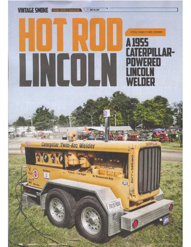

I put 2 guys burning rod on this 1 for my small work like fence, but i'd recommend mig 4u because it'll work for fence and be your "shop machine".
