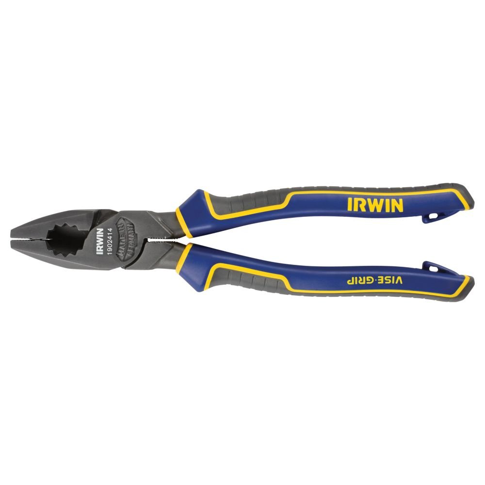

you guys are missing the pliers of the year, those new Irwin's made in Germany by NWS, high leverage and just feel better, easier to do the same job, lineman's available in 8" and 9.5" - $39 & $55 on amazon and most other places
strong enough to cut piano wire with little effort and they don't rust, which is big with me!
strong enough to cut piano wire with little effort and they don't rust, which is big with me.
I dun theen so Pancho! :willy_nil
No need to spend twice the money.
And if you ever had the Kleins, you would know that rust is not a problem when you take care of them.
dirtydogintex
Sep 28, 2012
927
inner looper-3rd Div Houston w & n
will the 9.5" model drive 16p nails? or persuade a ustrut fitting home? kleins will...
