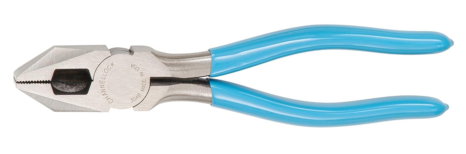

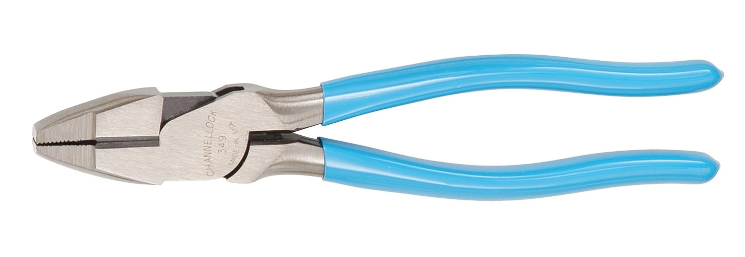

I’m having trouble picturing it. I was an electrician’s helper for a while, and saw linemen and channellocks both used this way, but didn’t know there were some intended for it.
Anybody got pics of the difference?
Round nose (New England style) top picture
Beveled nose bottom picture
