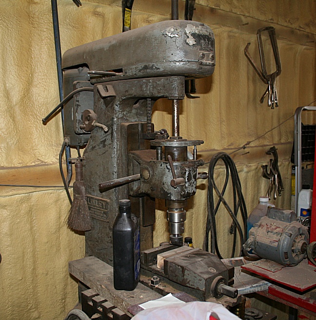

I have a line on a Linley Jig Bore that does not have the power feed. Does anyone have any picture of the inside of one in case I decide to make one for it?

First, I have to ask, what do you plan to do with the Linley? A jig bore is NOT a vertical mill- in fact, the early versions of the Linley (or so I'm told) don't even have what you'd consider mill style ways. As in the table just lays in the ways, with only gravity and the leadscrew keeping it from lifting.
Even the later ones with actual mill-style ways are really only suited for very, very light milling, as neither the leadscrews nor the spindle have bearings designed to take much side thrust.
My apologies if you already know all this. :D But I've been asked about Linleys enough times, in the context of using them as or turning them into mills, that its kind of a reflex now. :D

Actually you have that backwards, the earlier versions had dovetail ways, and the later ones switched to wider flat ways to use a different clamping methods because clamping on the gib could cause some slight movement.
No, I am not using it for milling, I have a Benchmaster for that, and the power feed I am talking about is for the quills power down feed.
It's funny though that even the makers taut them as also to be used for light milling. I know the collets they used would allow the tooling to be pulled out if too much of a cut were made.
