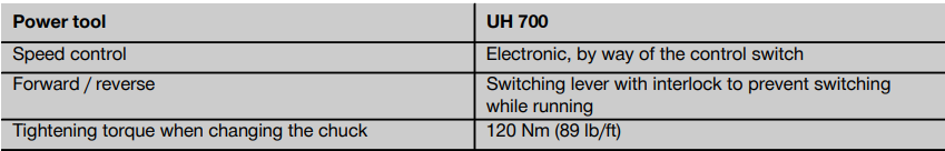

Ok, guys, finally found a supplier with a LLambrich CPM-13 R-1/2 on stock. I'll get it next week.
Now the problem seems to remove the Rohm from the Hilti. I looked inside the chuck and there is no screw inside.
Should I use wrenches on the spindle and "mouth" of the chuck?
The spindle is a 18 wrench...
And the hexagonal part is 19. It's more beaten up than I remembered...
The spindle and the heagonal piece rotate together, but I don't want to force anything.
I've found some instructions on an online Hilti manual, but that's for some other kind of chuck.
Can anyone shed some light on this dumb simple mind of mine?
S
spcv
Aug 11, 2023
7
https://www.hilti.ro/medias/sys_mas...-US-Operating-Instruction-PUB-5138090-000.pdf
If this torque spec is correct, it'll probably be on there pretty good, so prepare for a fight:
I would probably tighten a hex bit socket in the chuck and try to rattle gun it off while holding the spindle with a pliers wrench.
Well, that didn’t work. Both strategies, with a wrench and a hex key. I used my strength, then a hammer, then a Stanley sledge hammer, then the strength from the drill and finally I used an impact screwdriver while locking the spindle with the open wrench and holding the drill on a vise. It never moved. It’s like a single unique piece. Frustrating, to say the least.
The machine took quite a beating, I was afraid it wouldn’t drill correctly, but I tested it and is working fine, apart from the eventual bit slippage.
I’m usually pretty good with tools, but, gosh, I’m feeling so inept right now!

If there is no locking screw, then the chuck was threadlockered on, which is required for the heavier duty chucks since the design precludes the use of a locking screw.
This is to prevent the chuck from getting removed accidentally in reverse rotation.
As threaded arbors are designed to self tighten on the arbor in use, drill chucks can wind up very tight on the arbor.
S
spcv
Aug 11, 2023
7
Boy, do I deserve a facepalm. Better yet, a slap! I was afraid to go full throttle on the impact driver. Once I upped the Nm, the chuck came out!
