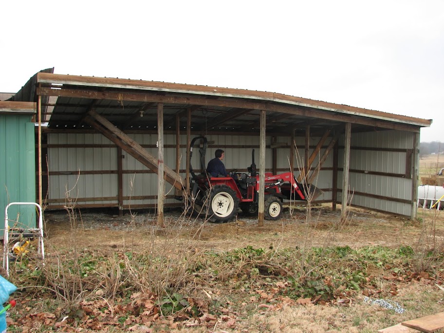

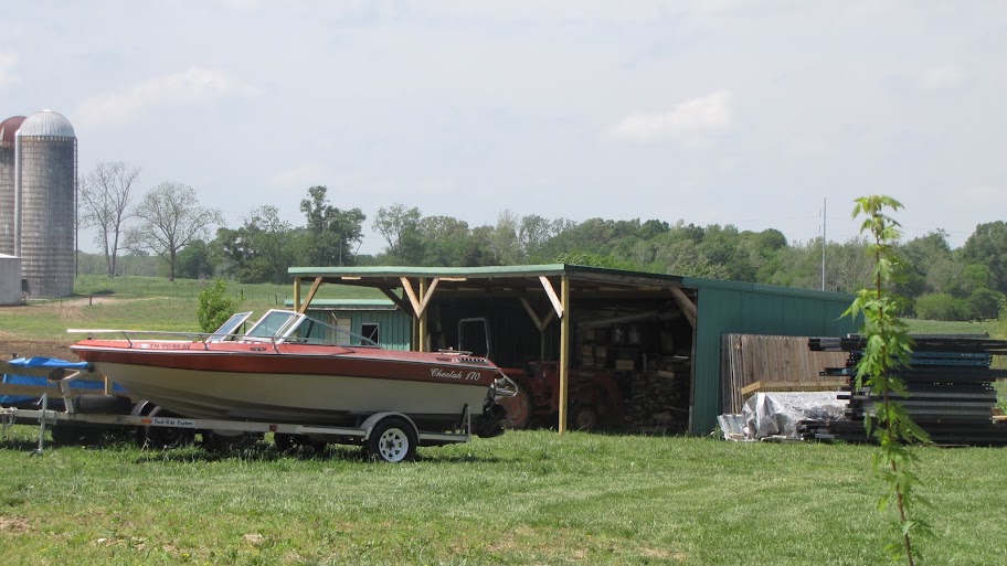

I've been lurking for a little while, but this seemed like a good time to make a first post...
In preparation for building a larger garage / workshop, and being frugal and not wanting to waste or destroy a good shed, I recently moved mine.
I haven't seen if yours is all enclosed or something else, but here is what I did:
My shed was about 48x12 total, with the first 12 ft being fully enclosed with a concrete slab, and the rest (32ft) being open on the front. It was a post frame building. I first removed sheet metal and boards that connected the two sections, thus creating a 12x12 enclosed and a 32x12 lean-to. as you can see in the picture, it also had a roof connecting it to another 24x32 workshop. This roof made it quite a bit harder.
To make a long story short, I moved the 32x12 lean-to first, by driving my 24hp Yanmar up under it, and then building bracing down to the bucket and the 3pt hitch. After breaking it free from the ground, I simply (HUGE EXAGERATION) drove it out to the field where I wanted it.
For the 12x12 enclosed shed still remaining, I dug around all of the 4x4 posts sticking through the slab into the ground, and then cut them off flush with the bottom of the slab. With the help of a relative's much larger tractor, my plan was to drag it out to the field where I wanted it. Well, it actually would have worked well the first time if I had wrapped my chains around the back edge of the slab, instead of the middle. With the chains wrapped through the middle, we started pulling, and before we realized it, the slab had split down the middle and we started pulling the building apart.:(
I re-rigged my chains around the back of the slab, and we resumed pulling. Having to make a coupld of turns, the slabs eventually worked themselves into a bad position that made us have to stop.
At this point, I decided it would be easiest to remove the entire building, fix it where we had partially pulled it apart and damaged it, and move the slab separately.
I first repaired most of what we had torn apart of the shed so I could move it, used a sledge hammer to bust the concrete around each of the 4x4 posts, and then, similar to your idea, I used the FEL on both my Kubota and my Yanmar, one on the front overhang, and one on the back overhang, and slowly moved it (by myself!) off of the slab. At this time, my dad and other relative with the tractor showed back up, and we used chains to move the (now 3) broken sections of concrete slab into place. Once the concrete was in place and mostly back together, my dad and I, one on each tractor, moved the shed back in place on top of the slab.
After patching the concrete, resetting all of the posts, and re-nailing all of the sheet metal between the two sections, I'm honestly very proud of how it turned out and how perfectly usable it still is. It was a good experience and I learned a lot from it. I still need to replace or cover the window openings where the glass busted out.
Lessons learned -
I would have braced everything move before doing any moving
I would have started off more slowly and checked everything more regularly before damage occured.
I don't have any closer pictures of the final product:
If you haven't started dismantling your shed yet, I just wanted to try and convince you to save time and effort and just move it as it is, just brace everything much better than I did.;) Just wait until the ground is relatively solid so you don't destroy the yard and possibly dig ruts.
