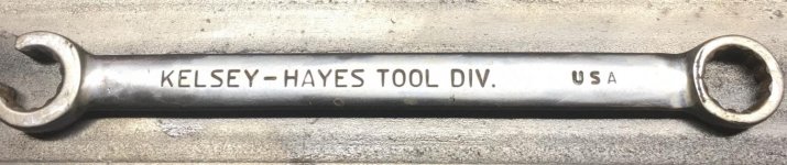

It’s an odd combination wrench. 7/16 line nut with 7/16 box end. No offset, it has a straight profile. Seems very well made. I don’t know a ton about these but there is some information. Very interesting.
Is there any other brand that combines a line nut, with a same size, box end? Seems redundant. And 0 degree in off set? ... not every application is identical, but virtually everyone has knuckles.
Oh well, I should not criticize anything I don’t understand. Perhaps I would appreciate it more if I knew it’s application.
I have been looking around for more of these since I found this one. I think about 6 weeks ago. Nothing yet.

These were first made by Kelsey-Hayes, the automobile wheel company. They were an early "flank drive" design that applied the pressure away from the corner of the nut. There were at least three companies that produced this design.
Chrysler marked sets show up on Ebay often. Loc-Rite sockets show up often there as well.
The 0 offset with box end is unusual. It was probably made for an application where installing the line also involved installing a hex fitting or a union with the box end was followed by tightening the line nut with the line wrench end.
My gut feeling is that most of these wrenches were used in OEM assembly operations where the manufacturer didn't want any rounded corners on the fittings when the assembly went out the door.

Your wrench was actually made by Bonney, being owned at the time by Kelsey Hayes. All Loc-Rite was made by Bonney.
Provincial
Sep 21, 2011
6,855
Near Salem, OR
So all my Loc-Rite wrenches marked "Kelsey-Hayes Tool Div." were made by Bonney? Alloy Artifacts says Bonney was absorbed into the Utica Tool Division of Kelsey-Hayes by 1964.
I seem to remember that the Loc-Rite patent was held by Kelsey-Hayes. Is that correct? My earlier comment of three companies making these wrenches meant K-H, Utica, and Bonney.
Alloy Artifacts has a page on Loc-Rite, featuring a wrench configured like the one the OP shows. http://alloy-artifacts.org/totw_locrite_flare_box_wrench.html
AA also has a link on that page to the Loc-Rite patent which was assigned to K-H and applied for in 1961, three years before the Bonney acquisition.
