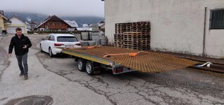

So the first thing we are going to adress before winter is fixing the old concrete floor. It’s very thin in several places and needs to be thicker in order to set up our two post lift in the near future.
So the first step was to tear up a part of the existing slab:
We hauled off several cubic metres of concrete. So the next step was to get the reinforcement for the slab. We use two mats AQ60 (6mm rod diameter mat), and laid a H-Pattern where the lift stands with 12mm rebar. Of course all is connected to one another with wire.
So the next step is going to be concrete. We gotta work fast in order finish the slab before the temperatures drop too far.
One thing I also did was to play around with paper cutouts on how to arrange the cars to fit 3 of them and still have access to the lift area (two squares are the lift posts).
Feel free to post any suggestions! [emoji6]

Looks good! Should utilize a respirator though, silica is no joke!

Yes, don't work without lung protection, rated for the work you are doing. Actually, that should be for all your PPE Personal Protective Equipment. Assuming your background, I'm surprised that you worked like that.
I'm a retired firefighter/paramedic, a lifesafety inspector and fire service instructor. One of the reasons I'm still-around is the care I took in using my SCBA and other PPE, and the knowledge I gained from always studying, what to-do and how to-do it. I have many co-workers who began after me who are deceased, and there's always a component of service-related health issues when someone dies early.
Anyway, looks like your reinforcement is going well. Get that poured!

Well, tried to convince him using one, will be more persistent next time! ;)

Yeah you´re absolutely ight, should have been more persistent on using a mask. Will do better next time - promised! ;) We still have a lot to learn in Life. :)
Yeah the reinforcement is done. Concrete should be here today! ;)
